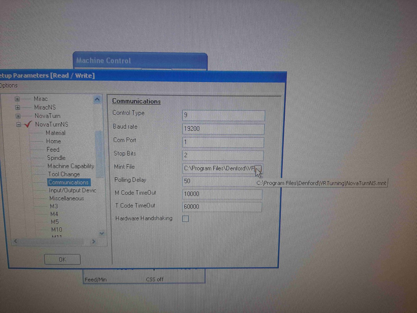

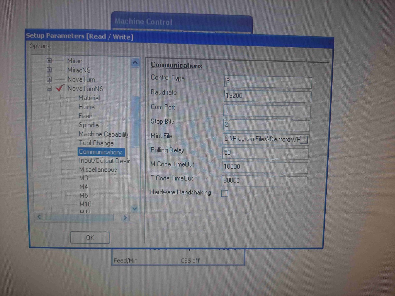

Here are some photos that show settings etc. Can anybody suggest what I might be doing wrong?

The only thing I can see software size that is different from default is the Baud rate, which should be set to 57600. maybe this will help.
Mitch

Hi Mitch, thank you for replying to my post. I changed it to 19200 from 57600!
I thought that the figure had to be 19200? I read that on the forum in another post. Is there a different baud rate depending on the machine or cable used?? I am not a computer man so don't really understand this type of stuff!
When I get home tonight I will try 57600 and let you know.
Thanks again for your help.
David.

Hi Mitch, I changed the baud rate to 57600 and it still would not connect. I restarted the pc and still no luck.
However I decided to reinstall vr Turning and using 57600 it now connects!! So great news. Many thanks for taking the time to suggest the different baud rate.
For anyone else reading this who are in the same position as I was. Here are the settings that work for my Novaturn NS (green display) with rs232 cable 25/9 pin connection.
OK!
