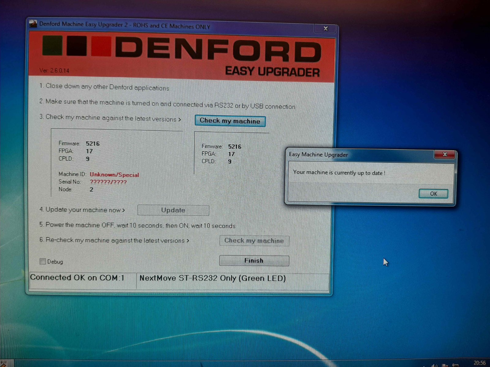

Easy upgrader 2 connects and says the machine is up to date.
However VR will not connect. The cursor just sits there spinning and I have to crash the program.

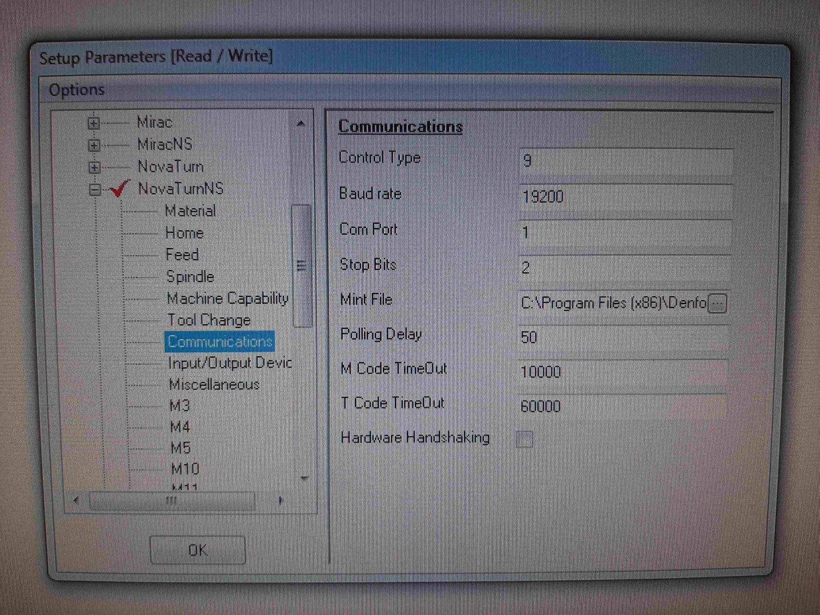

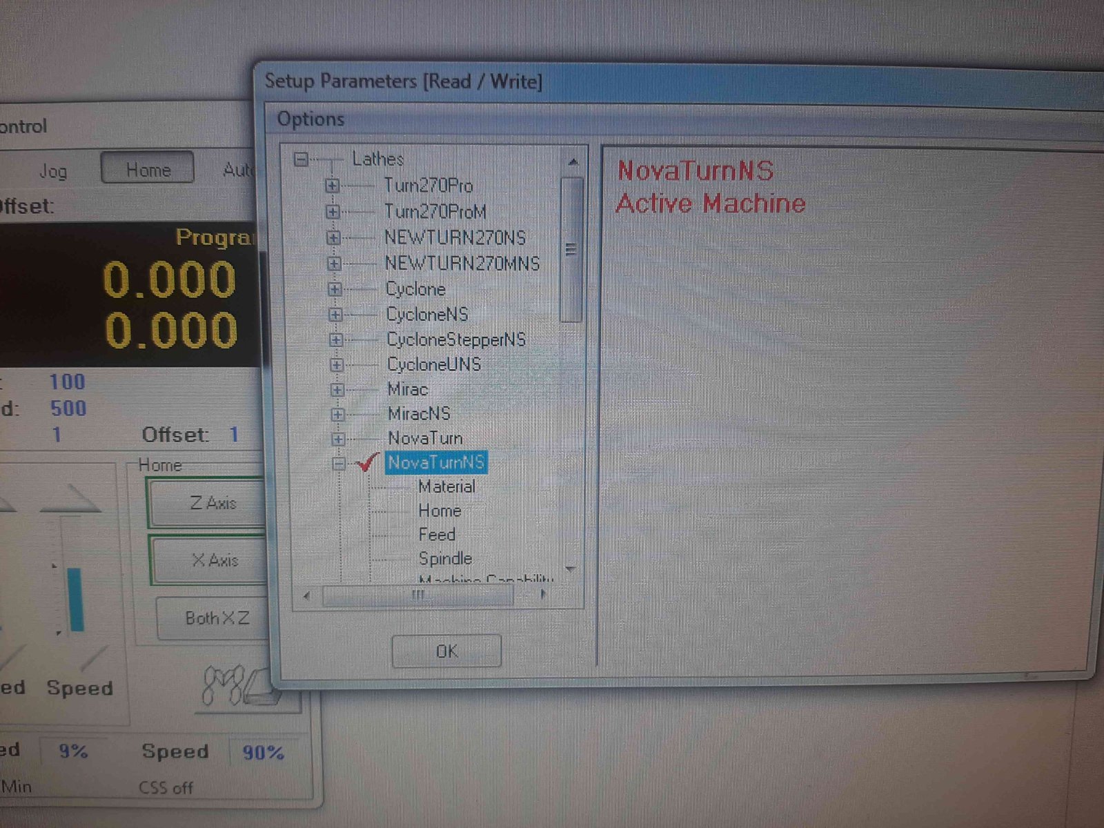

Here are some photos that show settings etc. Can anybody suggest what I might be doing wrong?

The only thing I can see software size that is different from default is the Baud rate, which should be set to 57600. maybe this will help.
Mitch
Re: HELP CONNECTING VR TURNING TO NOVATURN NS
Hi Mitch, thank you for replying to my post. I changed it to 19200 from 57600!
I thought that the figure had to be 19200? I read that on the forum in another post. Is there a different baud rate depending on the machine or cable used?? I am not a computer man so don't really understand this type of stuff!
When I get home tonight I will try 57600 and let you know.
Thanks again for your help.
David.
Hi Mitch, I changed the baud rate to 57600 and it still would not connect. I restarted the pc and still no luck.
However I decided to reinstall vr Turning and using 57600 it now connects!! So great news. Many thanks for taking the time to suggest the different baud rate.

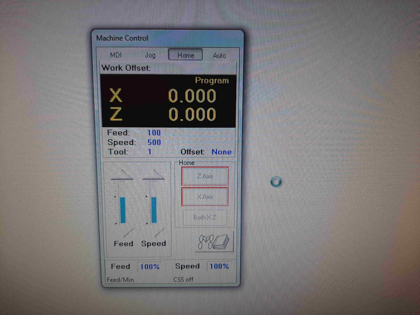

Controller on and 7 segment display shows an E flashing
Hit the "Machine" button and get an "8" on the display
Hit the "Home" button on the machine control dialogue and get a solid "h"
The x/z DRO's thenstart to climb to ridiculous figures (3500mm)
And that's about it. Software locks up.
