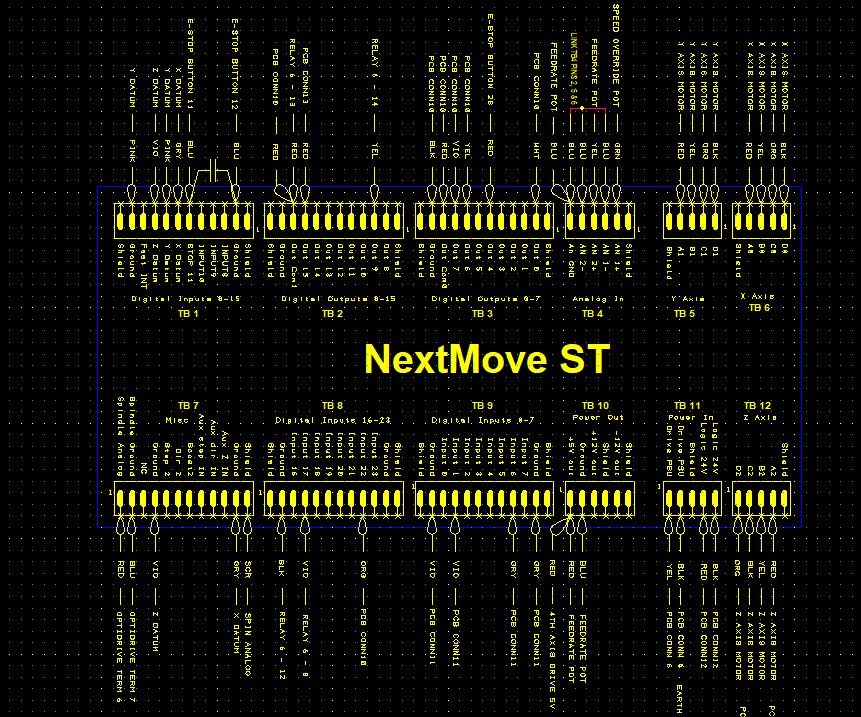

The Z home switch is wired to Terminals TB1 and TB7 with Violet wires.
We discussed how to view the Debug I/O in the software. If you remove the violet wire from the Z Datum input in TB 1 then try and home the machine If the Z home input is working the Z axis will think it is on the limit switch and drive down towards the table.
Pressing the ESC key will stop this.
If it continues to try and drive upwards then the input 14 is faulty
