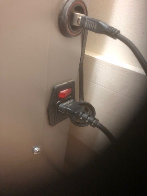

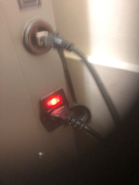

Just as important as the above is the fact that the Compact 1000 operates regardless of whether it is switched on or off (see pics). Is this normal?

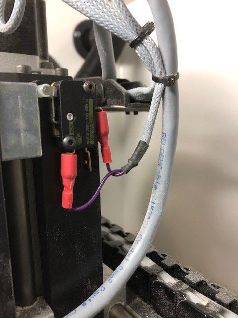

I have attached a picture of the limit switch wiring which is connected in the same way the others are albeit on this swich there are coloured wires whereas on the others (X&Y) there are not.
I once again replaced the limit switch with a new one but the same occurred.
The limit switch is being tripped (physically) but the Z axis motor is not switching off. I am pressing the ESC key to cancel the home as you suggested and then starting the process all over again, i.e. disconnecting from the real machine, re-connecting, double clicking to get the secret jog and moving all axis away and then re-homing each in turn. It's only the Z axis that is playing up.

Speaking of motors not switching off after they seemingly trip the limit switch - what is the deal with the compact 10000 on/off switch not functioning (able to use the machine in on or off position)?

Re: Compact 1000 pro E-stop and off on switch
the Z motor is not switching off as it is not seeing the switch state change, there is the possibility that the wire is damaged within the connectors so this could be why this is happening with new switches, also is there a possibility that the contacts on the switch are not the same so in fact it is not doing anything.
Are you sure the switch is being activated?
There is a bit a play on screw & it needs to be pushed towards the actuator before the 2 button head screws are tightened.

The On/Off switch problem I had was a weird one. this is where the On/Off main switch on the side of the Compact 1000 was not working, i.e. the router would power up regardless of whether being switched on or off!
I solved the above issue by accident, simply by undoing the C14 power inlet to test for a bad earth connection or if the switch had been incorrectly wired. Both were fine, so I screwed it back into the cabinet and. lo and behold, it now works! I am ordering a new C14 power inlet as I fear there is something amiss with it and I would rather replace to be on the safe side.

The limit switches I have used are all the same in that they use the same connectors for normally open or closed. The switch is being physically closed and so can I assume now it is a poor connection?

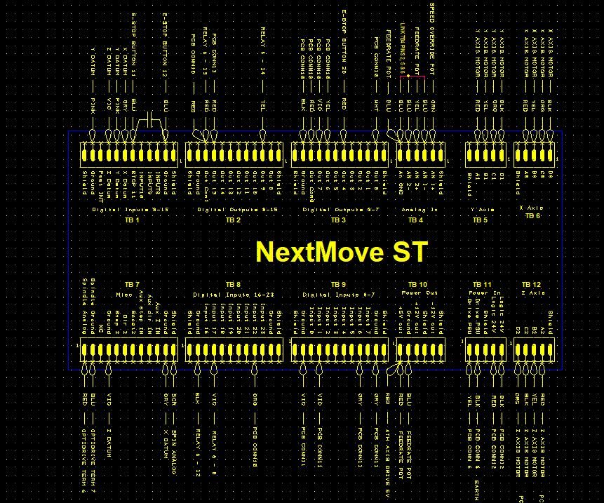

If i remember correctly the limit switch links back to the control board directly, you just need to use a meter and check the continuity on each wire, You could 'prove' if the issue is the wire/switch by directly wiring a switch to the control board and manually operating it.
II can't remember what pins it goes back to but if you have the diagrams you should be able to work it out
The Z home switch is wired to Terminals TB1 and TB7 with Violet wires.
We discussed how to view the Debug I/O in the software. If you remove the violet wire from the Z Datum input in TB 1 then try and home the machine If the Z home input is working the Z axis will think it is on the limit switch and drive down towards the table.
Pressing the ESC key will stop this.
If it continues to try and drive upwards then the input 14 is faulty
