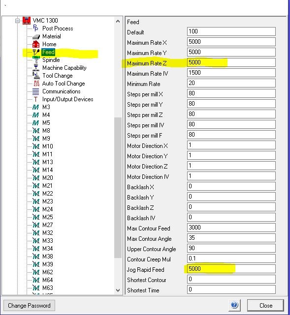

The machine stalled while making the rapid z movement. this could be for various reasons. Have you greased the machine rails as stated in the manual? Disconnecting the brake could be just a coincidence as I doubt that this is the issue. The brake needs to be connected otherwise the axes will fall when the power is disconnected and the machine may not home correctly.
It may be possible to increase the power to the Z motor by changing the switches on the Z axis drive. The homing feed rate is slower than the rapid so is less likely to stall.
If you go into Setup machine parameters enter the password of denny
you can then reduce the Z maximum feedrate but I would also reduce the max rapid rate to match this.
If you set it to 3000 or 4000 I think this will be fine.

I would also check the version of software you are using and make sure you have the latest. I don't think there will be an issue with the power. The brake is on the 24V DC rail and the steppers use a 63V supply so they would not effect that.
In fact with stepper motors the load is higher when stationary. Its possible the brake fiber washer is rubbing slightly causing the stall. Once a motor stalls it cannot correct its self but so will just sit there screaming.
If you take a photo of the stepper drives in the back of the machine there is a current option on the Z axis that can be changed.
The settings are by default:
MSD880
1 OFF
2 ON
3 OFF
4 OFF
5 OFF
6 OFF
7 ON
8 OFF
5000 Pulses/Rev 4.6A RMS
I would just lower the rapid on all 3 axes to 4000mm / Min and all will be well.

I did the adjustments per Steve's posts and added the heater on lowest setting and now can home and toolchange without issue. I'm happy the G28 goes to top of Z before homing X and Y. Thanks both
