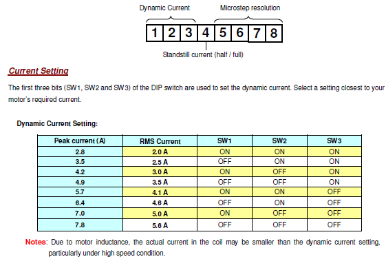

If you take a photo of the stepper drives in the back of the machine there is a current option on the Z axis that can be changed.
The settings are by default:
MSD880
1 OFF
2 ON
3 OFF
4 OFF
5 OFF
6 OFF
7 ON
8 OFF
5000 Pulses/Rev 4.6A RMS
I would just lower the rapid on all 3 axes to 4000mm / Min and all will be well.

I am up to date with V5_68
My drives are set:
1 ON
2 ON
3 OFF
4 OFF
5 OFF
6 ON
7 OFF
8 ON
Which the datasheet tells me is 5.7 Peak, 4.1 RMS, so one setting softer than your default listing

Set as our default should help.

Thanks, will set per your default and lower the speed next week and see what happens
Re: 1300 Pro Z axis brake applied on rapid home or toolchange
I did the adjustments per Steve's posts and added the heater on lowest setting and now can home and toolchange without issue. I'm happy the G28 goes to top of Z before homing X and Y. Thanks both
