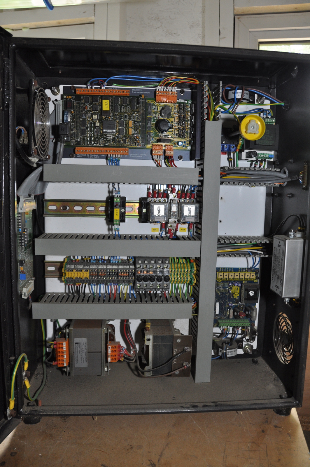

5. Inside the control box there is a circuit board on the left (see photo) with a ribbon cable attached to it – can anyone help me understand what that board is and what it does? It looks like something that’s been installed after manufacture.

Hi All,
Many thanks for your thoughts and replies. It took a long time (not a complaint) between posting my original questions and there being any kind of response here so I continued reading and went ahead anyway based on what I'd learned from around the web.
As Pete noticed, I have access to a slightly tatty but perfectly serviceable laptop, It doesn't have a parallel or RS232 port. I found that I could either spend £50-£100 on a second-hand and somewhat out of date old desktop computer, or I could go down the Ethernet route with a Smooth Stepper card. I chose the Smooth Stepper which cost quite a bit at £107, thinking that I'm future-proofing myself to some extent. It's a lovely piece of kit and was very easy to set up.
To go with this I bought a cheap Chinese parallel breakout board on eBay for £5.50 which seems to do the job well and includes 0-10v support for the variable speed spindle drive. I considered many (more expensive) Break out Boards but found it hard to see why it was necessary to spend more than a few quid.
I then took off the original controller board and mated my new kit with the existing stepper controller board through a 96-way DIN connector (£3.50).
After a lot of reading-up and measuring and head-scratching it all seems to work well with Mach 3. To be honest I'm feeling quite pleased with myself.
I still need to spend a bit more time getting friendly with Mach and I'm not 100% sure I've got all the settings optimised yet but I'm learning a lot as I go.
Next steps...start machining. Can't wait!
I'll post a couple of photos too to help anyone going through the same agony. Any questions? Please ask.
