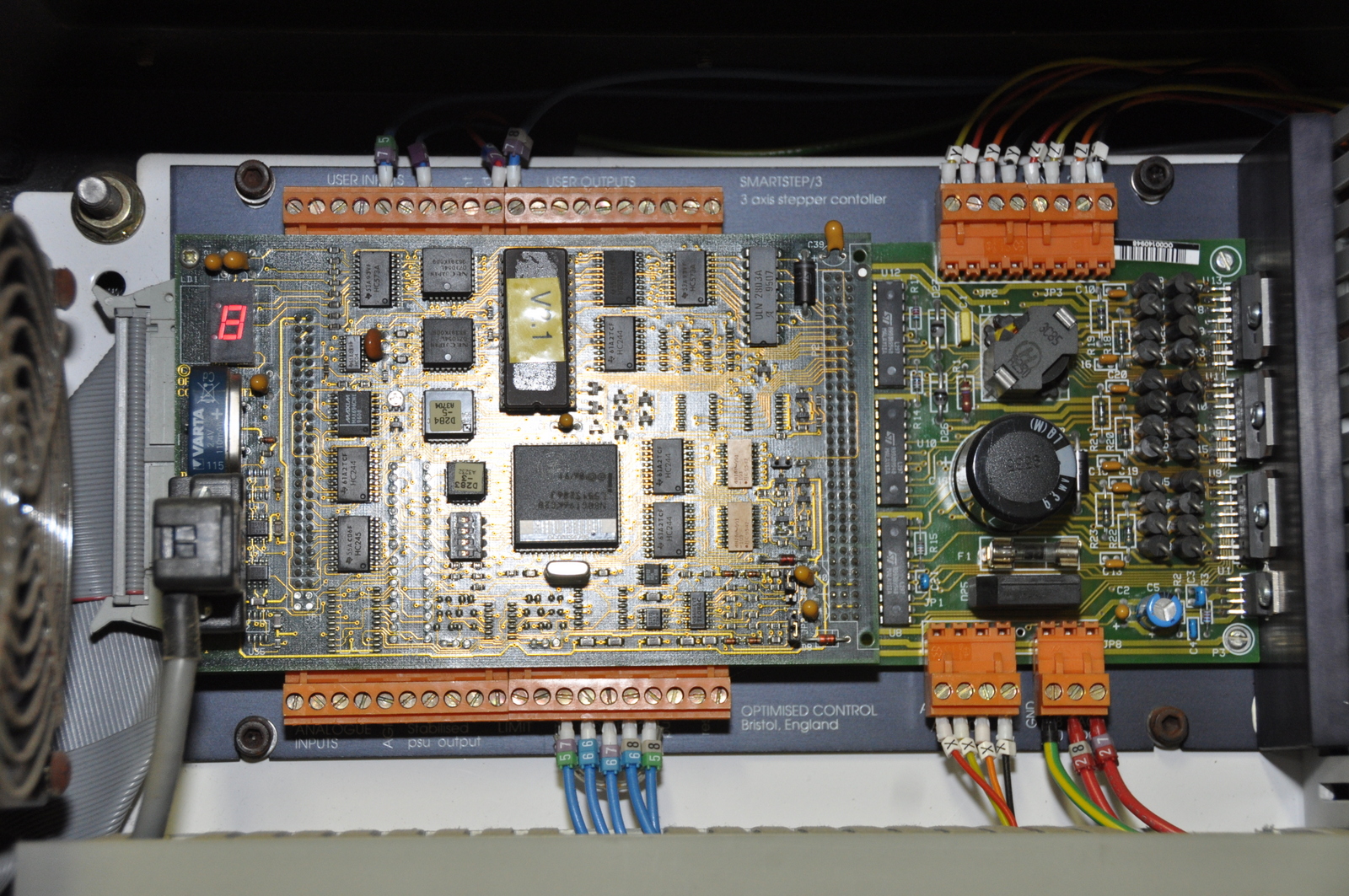

2. I notice my machine was built in 1996 (quite old) and has the smartstep/3 stepper board - is this too old to be realistically usable?
3. I know some of the Denford guys watch the forum – I’d love to know a little more about the history of this machine, any info you can give very gratefully received.
4. Although I have no software to run the mill, is there any “self-test” type routine that can be run so I can find out if everything works OK to at least a basic level?

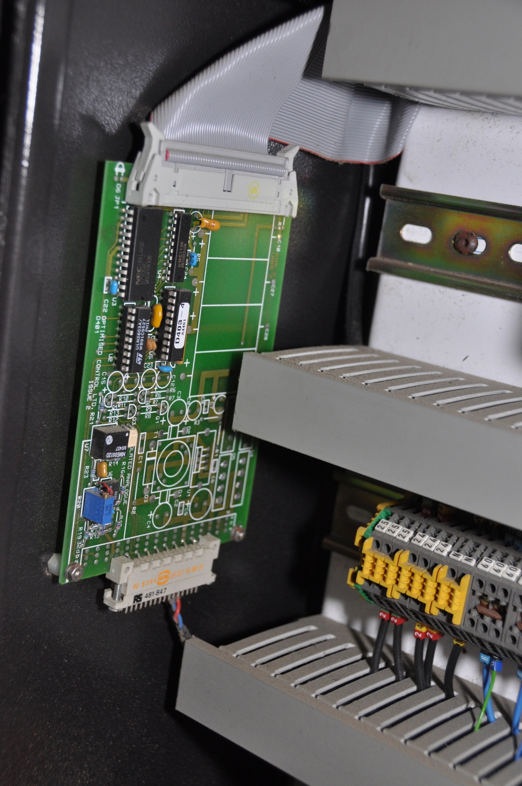

5. Inside the control box there is a circuit board on the left (see photo) with a ribbon cable attached to it – can anyone help me understand what that board is and what it does? It looks like something that’s been installed after manufacture.
6. Firmware: on the back of the control box, the plate says software version 2.96 yet inside the box there is a label over (what I guess is) an EPROM that says 2.1 – what do you think the software version is? Does it matter? Perhaps the V2.1 label on the ROM is just a red herring.

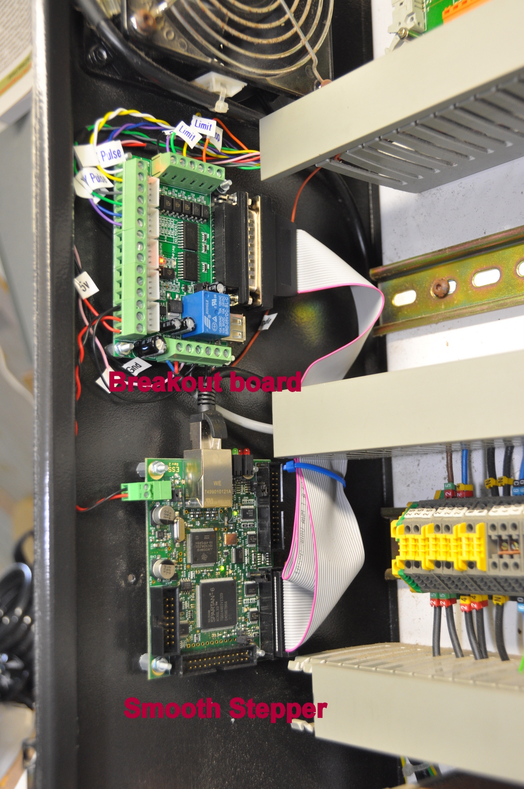

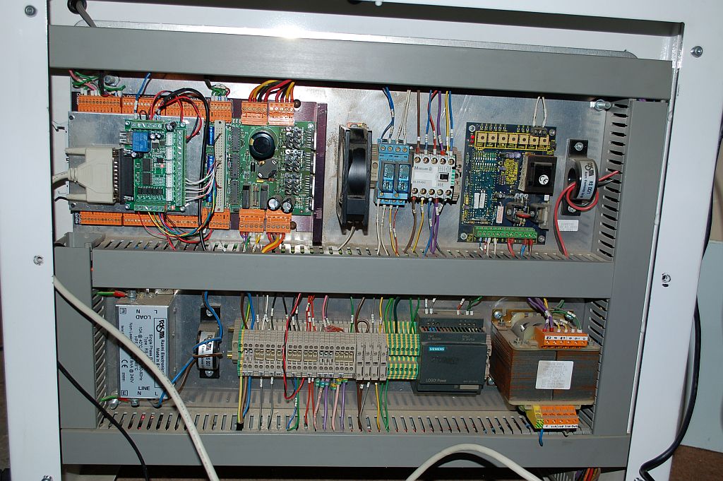

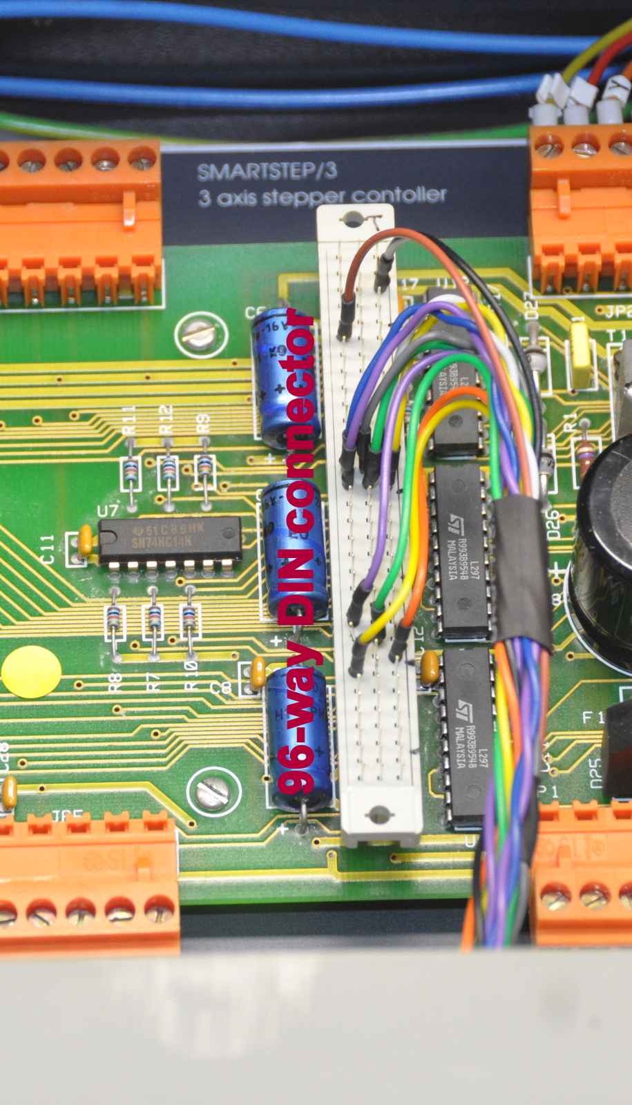

Many thanks for your thoughts and replies. It took a long time (not a complaint) between posting my original questions and there being any kind of response here so I continued reading and went ahead anyway based on what I'd learned from around the web.
As Pete noticed, I have access to a slightly tatty but perfectly serviceable laptop, It doesn't have a parallel or RS232 port. I found that I could either spend £50-£100 on a second-hand and somewhat out of date old desktop computer, or I could go down the Ethernet route with a Smooth Stepper card. I chose the Smooth Stepper which cost quite a bit at £107, thinking that I'm future-proofing myself to some extent. It's a lovely piece of kit and was very easy to set up.
To go with this I bought a cheap Chinese parallel breakout board on eBay for £5.50 which seems to do the job well and includes 0-10v support for the variable speed spindle drive. I considered many (more expensive) Break out Boards but found it hard to see why it was necessary to spend more than a few quid.
I then took off the original controller board and mated my new kit with the existing stepper controller board through a 96-way DIN connector (£3.50).
After a lot of reading-up and measuring and head-scratching it all seems to work well with Mach 3. To be honest I'm feeling quite pleased with myself.
I still need to spend a bit more time getting friendly with Mach and I'm not 100% sure I've got all the settings optimised yet but I'm learning a lot as I go.
Next steps...start machining. Can't wait!
I'll post a couple of photos too to help anyone going through the same agony. Any questions? Please ask.

Hi Alastair,
thanks for posting what you've done, it looks very neat. I'm in a similar, although not identical position.
I have a micromill that uses the same Denstep board, and I've bought the same breakout board. I have a PC with parallel port, so this is where we differ.
From your pictures it clear how you've connected the pulse and direction of the 3 axes, plus the homes and stop switches, I like how you've wired the latter to the 96way connector, I was going to wire direct. What's not so clear is power, grounds, and the spindle wiring. I'm not sure whether to power the breakout from the USB port on my PC, or from the TB10 connector on the Denstep board. Can you share what you've done any why.
I'm looking to use LinuxCNC, but could be persuaded to use Mach3, what I don't know is how to set up the timings for the driver, still, that's a problem for another day.

Andy,
Sorry for the slow response - for some reason I don't get email notifications when there is a change to this thread, despite subscribing by email.
My reasons for taking the power from the stepper controller board are:
a) Both 5v and 12v are there anyway and I preferred the control box to be as "self contained" as possible. Plus 12v is not available from USB anyway.
b) The gnd, 5v & 12v are presented on dedicated screw terminals....maybe I'm old-fashioned but somehow I prefer to use the screw terminals rather than solder onto the 96way connector, just feels more solid that way.
Spindle wiring:
- The 0-10v to control the speed comes from the 0-10v output on the breakout board with the PWM signal to drive this coming from the parallel port. you need the 12v supply from the stepper board (or elsewhere) to give you the 0-10 output. This 0-10v output is taken directly to the spindle control board.
- For the spindle on-off control, I used the relay on the BO board to pull the coil on the Spindle Go Relay (SGR) to ground, I hooked this through pin c6 (User Output bit 0) on the 96-way which is connected through to the coil of the SGR relay - this may vary from machine-to-machine.

Hi Alastair,
Thanks for the reply, I had a bit more of a play this evening. I'd already got the 3 axes moving, but nothing else due to the lack of a 12V supply. I was using the 5V from the USB, tonight I swapped over to the 5V supply from the Baldor board, this also worked fine. Sadly when it came to wiring in the 12V supply it seems to be dead. I'm not sure what to do now, I can either try and fix it, but without a schematic that might be more trouble than it's worth, or maybe add an external 12V supply.
Re: Bringing my Novamill back to life
Thanks again Alastair, you saved me some head scratching.
I removed the Baldor board with the intention of trying to fix the 12V supply at work, then whilst driving in it dawned on me that I could just use the 24V supply already in the housing. So instead of playing electronics I decided to make a plate that sat where the Denstep had previously sat that I could mount the breakout on to. That worked OK, I shortened the wiring to suit, wired in the 24V, spindle relay and 0-10V, and with a bit of jiggery pokery it now homes, moves, spins, and cuts 2.5D air :)
The one bit of knowledge I'd missed was that the spindle PWM was on the parallel connector pin1.
