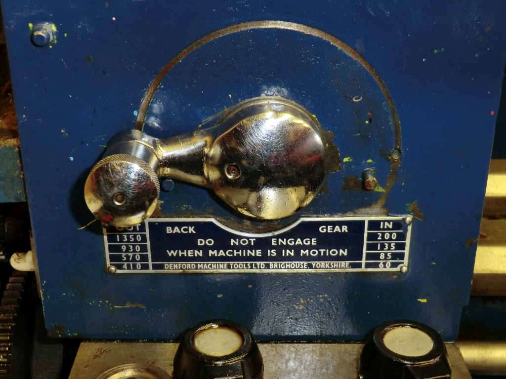

I wouldn't be to hung up on the design of the backgear handle, if you can make one just now, you might be able to get a Proper one in the future.
I have attached a couple of Pics of the one on my Lathe, which is an older model than yours. It is held on by a grubscrew and has a detent arrangement to keep it in a selected gear.

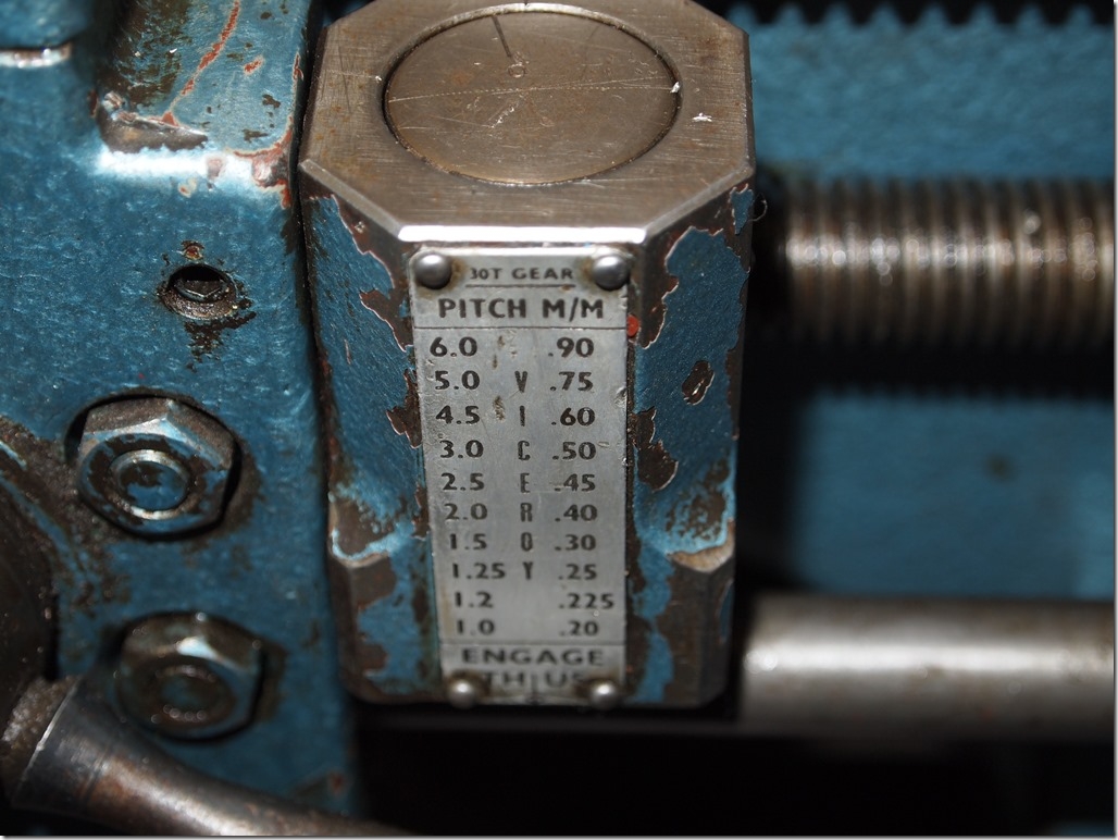

I got a Thread Dial Indicator & Back Gear Selector Lever off ebay, so my lathe is complete.
Will start the set up this year.
Back Gear Lever 1.jpg (595.03 KiB) Viewed 24308 times
This photo is of ebay
tdi 1.jpg (328.19 KiB) Viewed 24308 times
