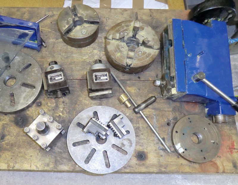

Now the good stuff, I have got an old lathe, a Denford Viceroy Mk 2 T.D.S.1/1. serial No 28506
with 2off 3 jaw chucks, 1 off 4 jaw chuck, 4 face plates, full complement of change gears,
3 Kingston Aloris wedge quick change tool posts & other tools.

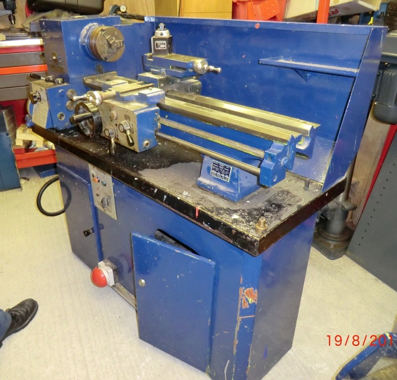

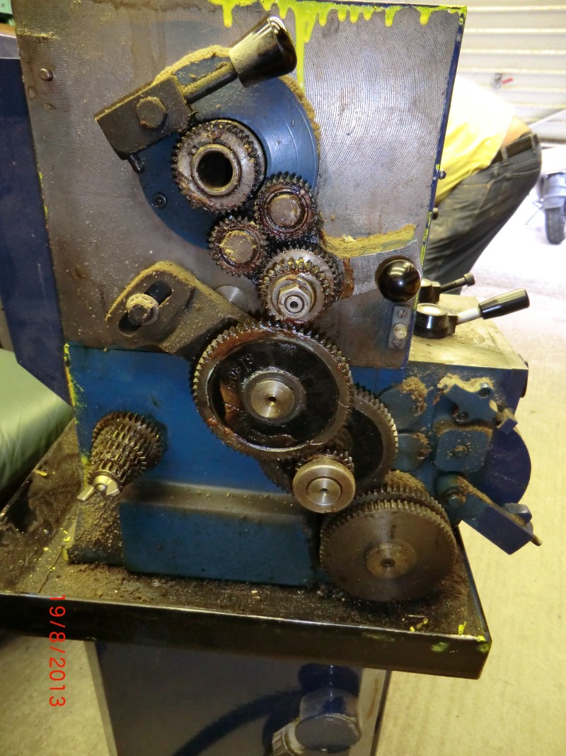

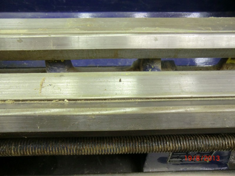

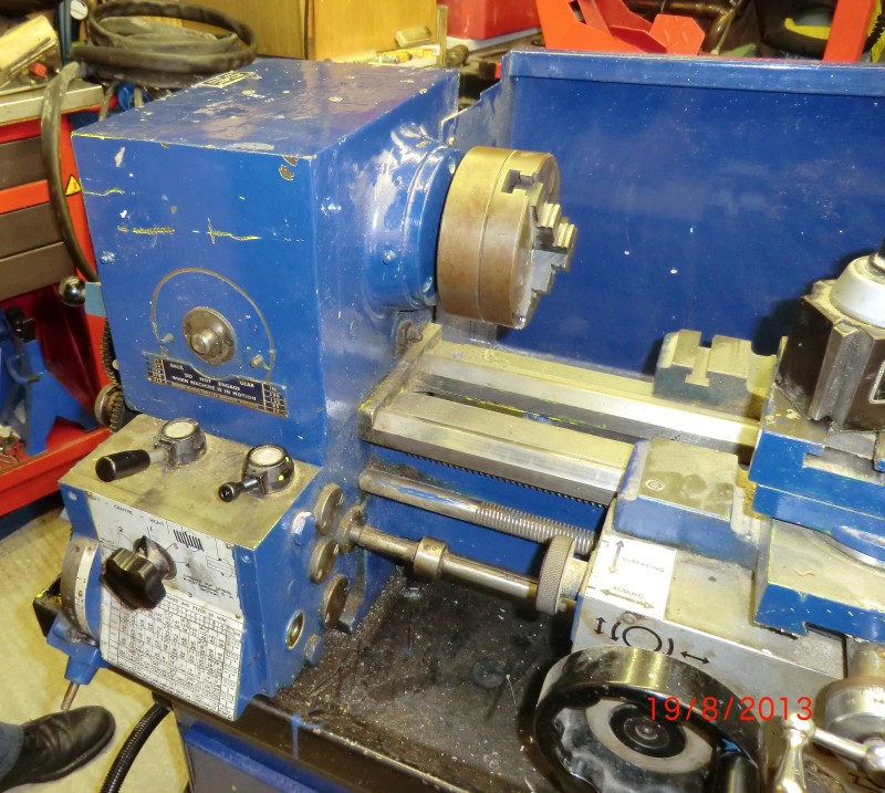

The viceroy lathe arrived today, some photo of the lathe.
Now I have had a good look at it, it is not that bad.

Nice buy Jeff, £300 is a great price given all the bits you got with it.
Seems to me that making a back gear lever would be a great first job for the lathe...

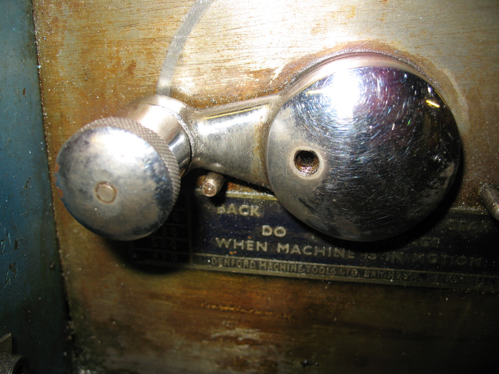

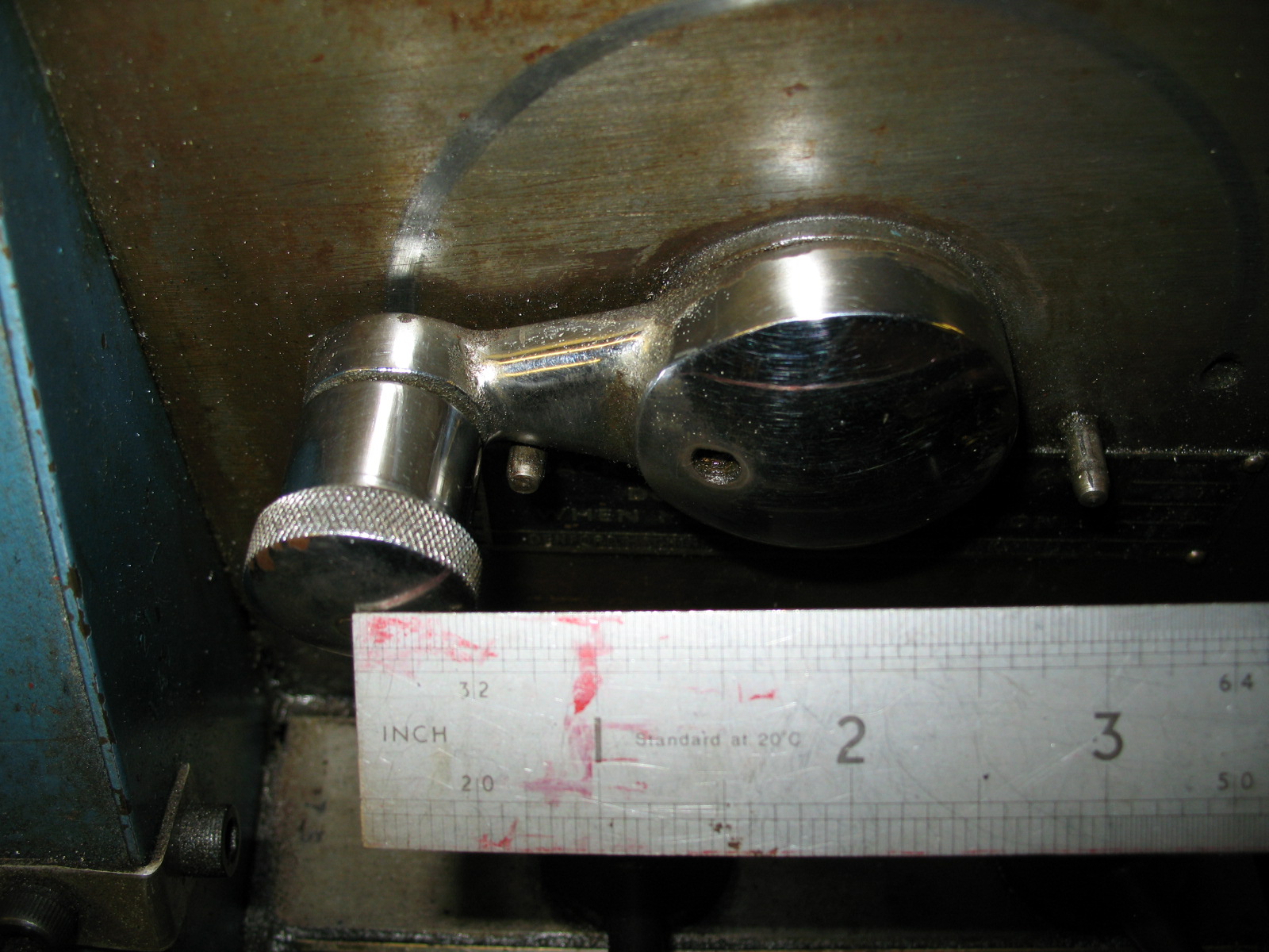

I wouldn't be to hung up on the design of the backgear handle, if you can make one just now, you might be able to get a Proper one in the future.
I have attached a couple of Pics of the one on my Lathe, which is an older model than yours. It is held on by a grubscrew and has a detent arrangement to keep it in a selected gear.
Les.T

Sorry for not getting back to you, thanks for the info will make one if I cannot find one, but would like
an original if possible.

I have removed the motor 3 Ph 900w 1.2 Hp, tested out OK.

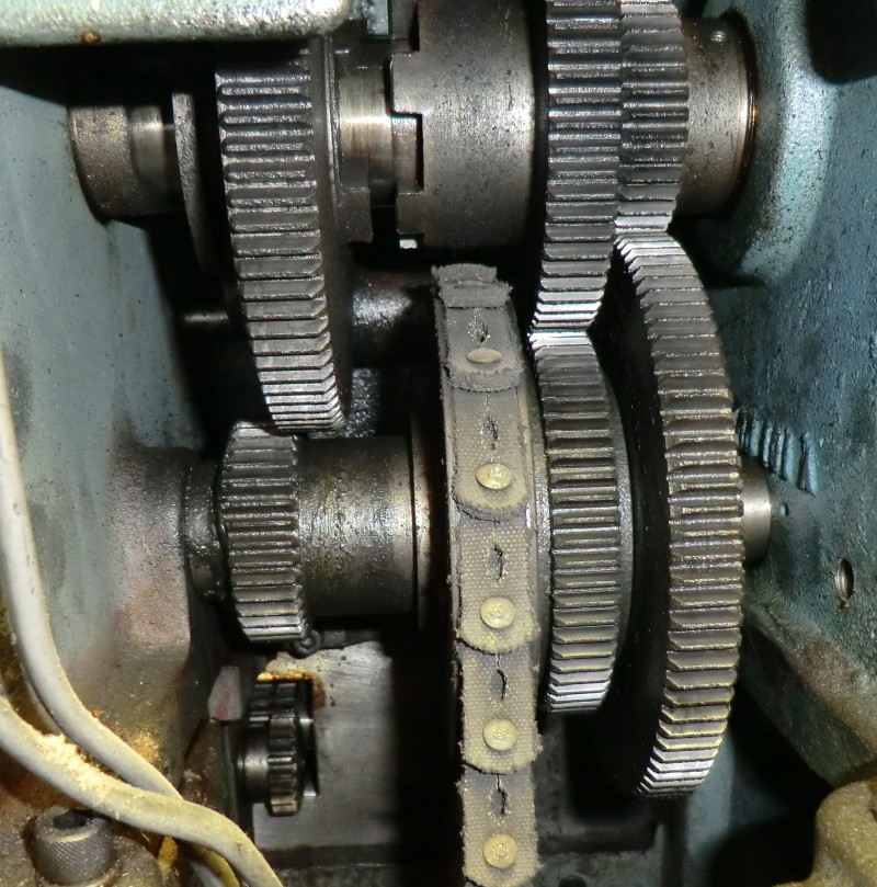

Strip off the top of the lathe, cleaned out the gibs & slides,
full of sawdust & a resin of some sort, it must be from the wood ????????,
the parts look v/good under the crap, cleaning up very nice.
I will do more as I get the time & put on some photos of the parts that have been take off & cleaned.
