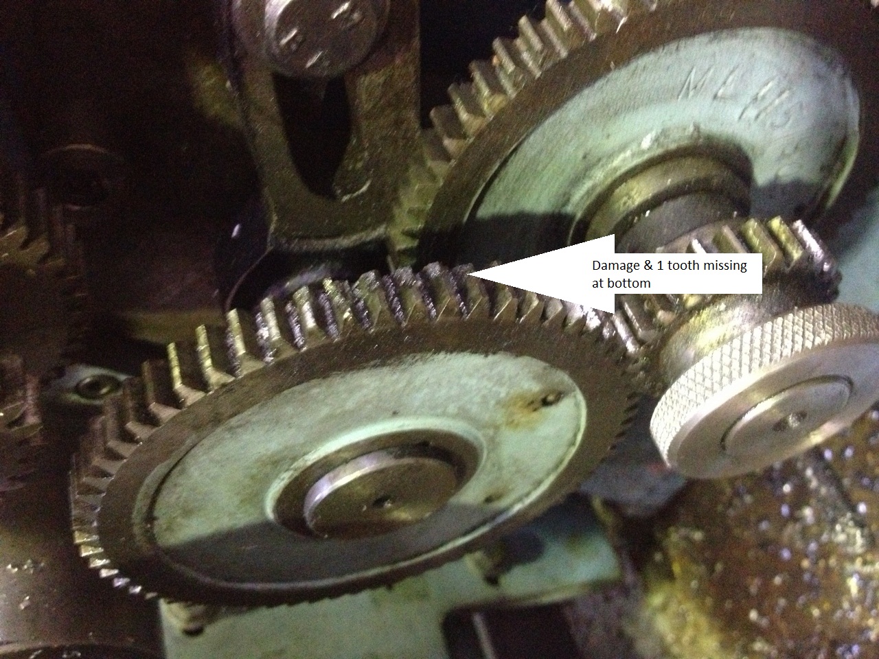

Just wondering if anyone can give some advise on the Viceroy I have just bought, I know very little about lathes let alone the Viceroy 280.
It has some missing parts, broken timing belt, a tooth missing from a pulley and a tooth missing in the gearbox, I've taken some photos for you to see (post separate), I'm not sure if the chipped cogs will be ok or not, really after some experienced advice.
A lot of the problems have come about with the machine being operated with the side cover open as there were lots of swarf in there on the gears.
Got a new belt but not sure how to fit, and not sure how line up the gearbox cover levers etc

Hi Allan,
You have exactly the same model as mine - including the nice ball handles on the top-and cross-slides, before they were changed to plastic ones.
Let's start with the biggest issue - the photo with the arrow 'something missing?
You are missing the auxiliary motor and drive mechanism for the variable speed. No point in trying to replace those IMO, unless you come across one being broken for parts (unlikely!).
Assuming the main motor is 3-phase, then best buy an inverter - will give you an even greater variable speed range than the original, with a soft start as well.
You could either keep the vari-speed pulley/belts that you have, or change these for a 1:1 toothed belt drive and sell the vari-speed bits for spares.
The damaged / missing teeth on the LH end - good thing is they are only on the feed / threading gear train, so you don't need those gears for basic turning.
They don't take a lot of load and run fairly slowly so, seeing as you have welding gear in your pictures, you could try building up the damaged / missing teeth then reshaping them by hand.
Alternatively, I think the drawing for them should be on here somewhere, so you could turn up a new blank and find a local jobbing shop (or maybe someone on this board?) with a gear cutter of the right DP to cut the teeth for you.
I see what you mean about swarf in the gearbox itself - can't explain that! I also can't see the broken tooth in there. Can you highlight it?
In the second picture - there is a threaded stud that sticks out from the bottom of the headstock. Did that have a set of spare gears on it? You'll need those to get the different feeds and threads as shown on the gearbox plate.
Overall, it hopefully shouldn't take too much work to make it into a decent machine again.
Hope that helps for starters.

Thanks for your help Andy
Looking at the gearbox a second time maybe it isn't that bad, some wear but should be ok, it has 1 missing tooth on the virtical cam that lifts the front gears up.
It was an eBay purchase, just took a chance with it, looks like a good machine but I dont want to waste money if they're not very reliable, already had to buy a chuck & tool post, no spare pulleys. The toothed timing belt snaped and I've got one coming tomorrow, what would cause it to break? I'm thinking abuse like you said.
I'm going to order a invertor as it seems much better anyway and won't be wasted if I were to change to another machine, but I do really hope the Viceroy will be a good enough machine.

Hi Allan,
I wondered if it was the one recently on ebay.
Many people regard these as good, well-built and reliable machines - but they are not immune from damage through abuse, like any other machine tool!
The symptoms suggest that someone tried to engage the feeds / threading incorrectly (maybe combined with some general neglect) - it is important to follow the sequence described on the gearbox plate and in the manual for this.

I have a much better feeling about this now, I just put the gearbox plate back on and it all seems to turn ok, I think you are spot on about the abuse as the belt, chipped gear etc.
