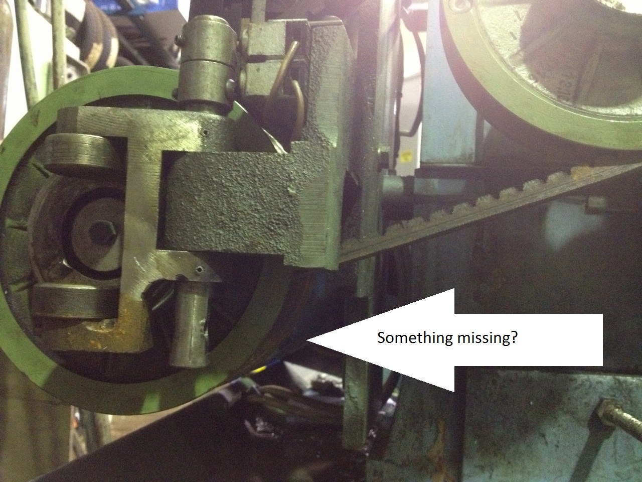

Let's start with the biggest issue - the photo with the arrow 'something missing?
You are missing the auxiliary motor and drive mechanism for the variable speed. No point in trying to replace those IMO, unless you come across one being broken for parts (unlikely!).
Assuming the main motor is 3-phase, then best buy an inverter - will give you an even greater variable speed range than the original, with a soft start as well.
You could either keep the vari-speed pulley/belts that you have, or change these for a 1:1 toothed belt drive and sell the vari-speed bits for spares.

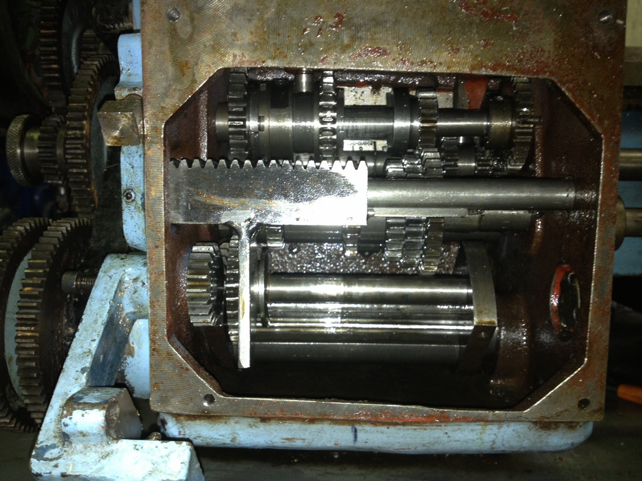

The damaged / missing teeth on the LH end - good thing is they are only on the feed / threading gear train, so you don't need those gears for basic turning.
They don't take a lot of load and run fairly slowly so, seeing as you have welding gear in your pictures, you could try building up the damaged / missing teeth then reshaping them by hand.
Alternatively, I think the drawing for them should be on here somewhere, so you could turn up a new blank and find a local jobbing shop (or maybe someone on this board?) with a gear cutter of the right DP to cut the teeth for you.
I see what you mean about swarf in the gearbox itself - can't explain that! I also can't see the broken tooth in there. Can you highlight it?

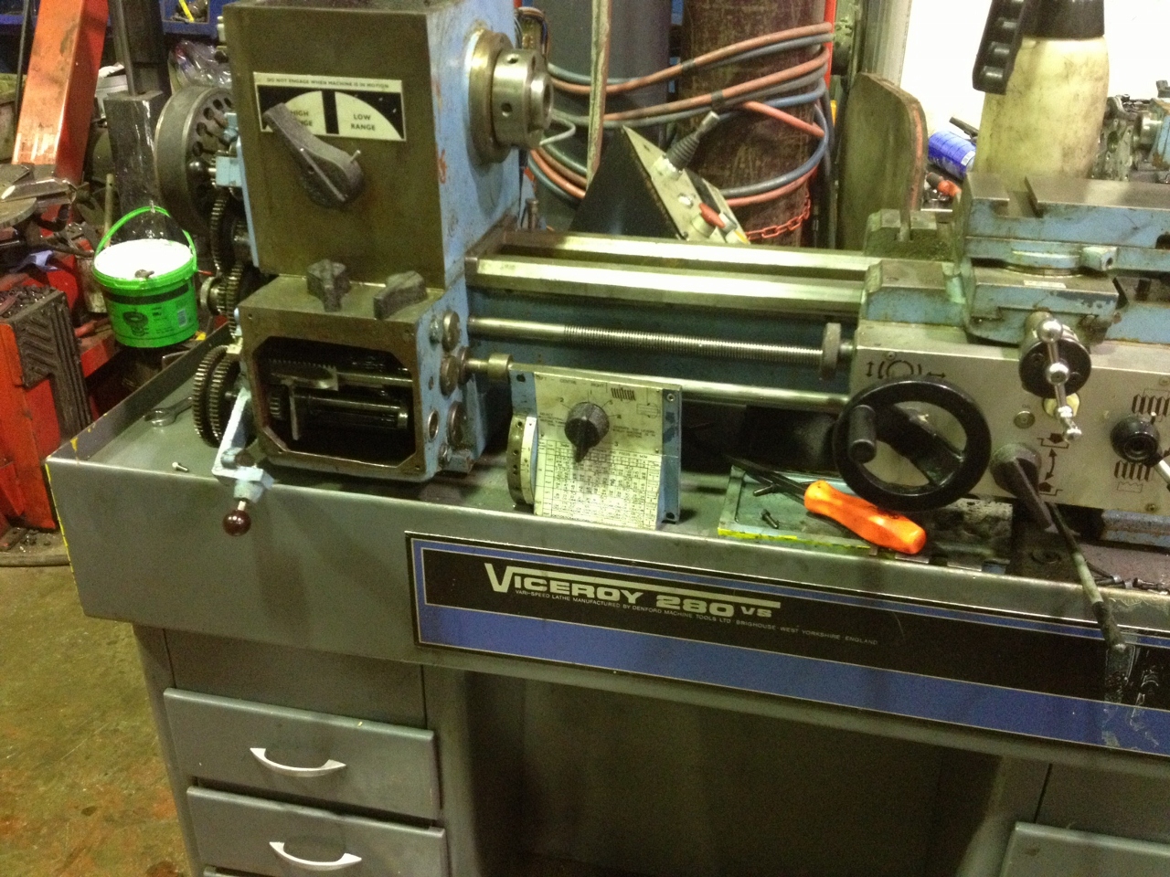

In the second picture - there is a threaded stud that sticks out from the bottom of the headstock. Did that have a set of spare gears on it? You'll need those to get the different feeds and threads as shown on the gearbox plate.

Looking at the gearbox a second time maybe it isn't that bad, some wear but should be ok, it has 1 missing tooth on the virtical cam that lifts the front gears up.

Want to have a go at repairing the damaged pulley, going to braze and machine back on my mill, I would like to get a cutter but can't for the life of me work out what the DP is?
Any ideas?
Overall diameter is 105mm, 64 teeth
I don't want to try the gearbox until I've fixed it
Allan
