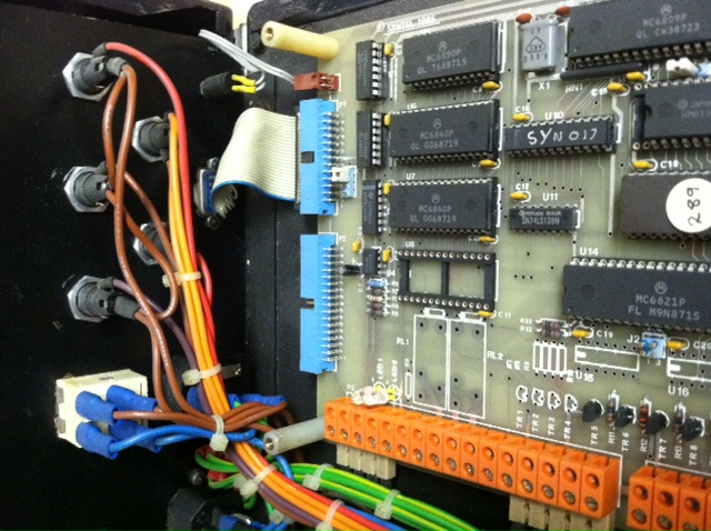

What I meant with my first query was replace the DB-9 socket with a DB-25 socket. I've found that currently the DB-9 (on the rear of the machine, to interface with a computer) plugs into a A16-LPH 26 pin socket on the board and could be easily replaced with the same part except in the DB-25 variety. Would this work?

The thought is still lingering though, is it possible to just connect a new ribbon cable with more pins than the existing one? You can see what I mean in the photo where the ribbon cable connects to a DB-9 plug and the BOB. It would certainly be the cheapest, quickest, and most simple solution. It almost seems TOO easy to be true.
Could that work? Is it worth trying?

I think that 9way to ribbon is probably RS232 comms to the old GSM controller board.
That controller board will be useless to you once the new BOB is fitted - whatever commands or data it takes is unknown to us.
All you have to do really is find the step+direction wires to the drives and wire them to the BOB then wire the BOB up to the PC via ribbon / 25 way cable
