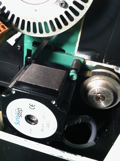

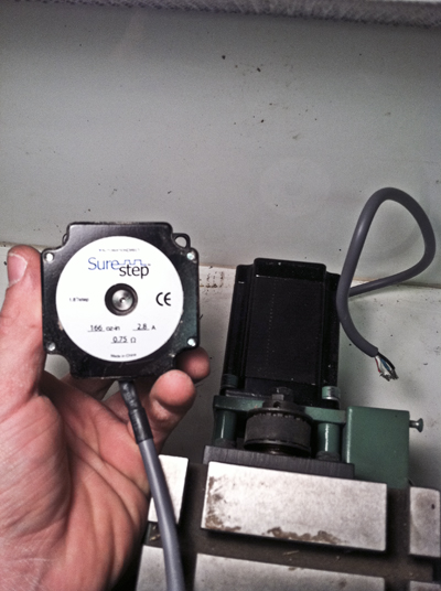

Sadly the steppers on the machine were dead. The X axis was missing a lead (not sure why...?) and the Z just did not work. I tried with 2 different drivers and got no response. Thankfully the spindle motor still works.
I got new motors from automationdirect.com. For the Z axis I used a 166oz stepper (that's all that would fit in the cabinet), and I used a little larger stepper for the X because there was room for it, at 276oz.
Tomorrow I hope to have the steppers, limits, and e-stop wired to the board and then deal with the relay. Eventually I will work on the spindle speed override.

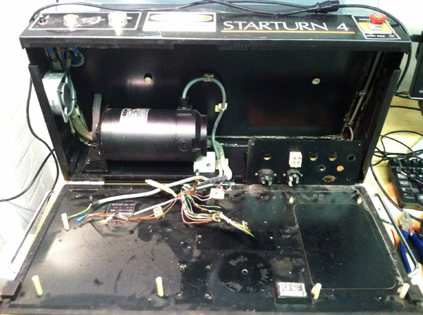

I ripped out the rat's nest inside and got a fresh start. It looked like this:
...and then this! Ah, much better now!
Bolted on the X axis stepper...
then the Z axis.
then the Z axis.

For someone claiming to be unskilled at wiring, that 2nd photo looks pretty daunting :shock:
At the end of the day those old 'rats nests' were far too complicated IMO - too many different transformers, voltages, converters and logic boards for what is basically two steppers and a spindle motor.
