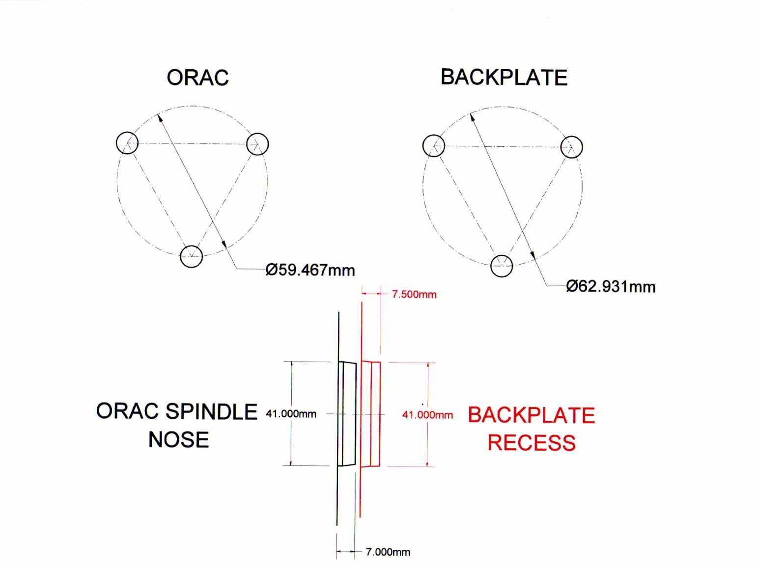

Posted: Sat 14 Aug , 2010 18:41 pm
by welderfabrod
Hope this works.
Dims from Orac nose and purchased Emco back plate.
Rod

Posted: Wed 25 Aug , 2010 16:31 pm
by welderfabrod
Thanks for the response Andy I'm pretty sure I've got my dims right but I've got a job set up in the 3 jaw at the moment as soon as i've finished I'll check them again and let you know.
The chuck location spigot on your back plate at 55.5mm is much to big for the Orac as its max tapper dia. is only 41mm which is why I found the plate supplied by Pro Machine Tools a bit wierd because it almost fitted but not quite if you see what I mean. On my drawing black is the Orac spindle nose and red is the recess in the supplied backplate.The mounting stud hole positions in their back plate (thats the 3 holes for mounting plate to spindle) I could have redrilled no problem but the spindle nose tapper I can do nothing about. I purchased the plate with a 4 jaw chuck fitted.
Also the Orac has 8mm clearance holes in its spindle nose to take studs fitted to the backplate.
