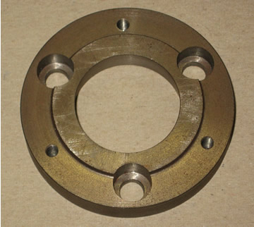

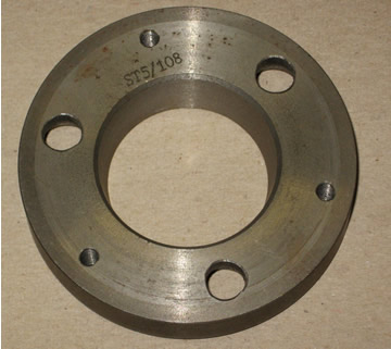

Re: Orac spindle nose taper
Rod,
Are you sure about the 59.467mm PCD?
We've found a small stack of backplates that are marked ST5/108 - suggesting that they were for the Starturn machines that I understand had the same nose as the ORAC.
The 3 bolt holes measure in at near enough 52mm; 60mm PCD would give hole centres of 51.96, so this would seem a sensible 'round' dimension as designed.
O/D = 79mm
Thickness = 15mm
Bolt holes 9mm dia, C/Bored dia 14 x 11 deep
Chuck location dia = 55.5 x 2mm high.
The chuck bolt holes appear to be M5 on 65mm PCD, but you'd obviously need 4 different ones for 4jaw chuck.
ST5/108 backplate frt view

ST5/108 backplate back view
Orac backplate back.jpg (28.13 KiB) Viewed 32206 times
Thanks for the response Andy I'm pretty sure I've got my dims right but I've got a job set up in the 3 jaw at the moment as soon as i've finished I'll check them again and let you know.
The chuck location spigot on your back plate at 55.5mm is much to big for the Orac as its max tapper dia. is only 41mm which is why I found the plate supplied by Pro Machine Tools a bit wierd because it almost fitted but not quite if you see what I mean. On my drawing black is the Orac spindle nose and red is the recess in the supplied backplate.The mounting stud hole positions in their back plate (thats the 3 holes for mounting plate to spindle) I could have redrilled no problem but the spindle nose tapper I can do nothing about. I purchased the plate with a 4 jaw chuck fitted.
