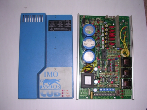

does anyone know how many kilowatt motor this can run?
Cant find a manual.
Looks like this:
/Jim

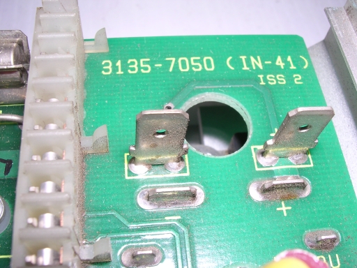

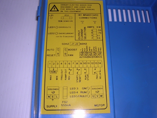

The cover on my vfd is missing so I took pictures on the numbers I found.
The top picture have the pin on 1,5kW, but I dont want to by an 2hp motor until Im sure.
/Jim

hi Jim,
I too used to have a similar inverter/VFD on my Denford Senior 3C mill.
The model number is on the top line of the black data plate at the top right of the blue plastic case; it then goes on to state the capacity in KVA on the next line - in my case my old VC-150 was rated at 3 kVA

OK Jim, sorry I had initially assumed the first photo you posted was of your drive.
Have just pulled my old VC-150 out

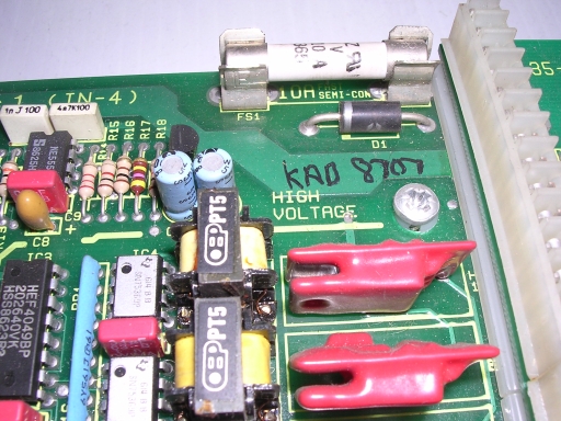

First thing is that there doesn't appear to be any marking on the board as to its model or capacity BUT on my unit, and in the one whose photograph you included, the is a paper Quality Check label affixed to the top of one of the capacitors and that bears the hand-written model number.
Your unit is, I think, later than my VC-150. The inspection date and inspector's initials are marked on the paper label and in ink on the board (at least in mine). My unit bears " 87-07 " which I had interpreted as likely to mean July 1987 - but since yours bears " 90-26 " maybe its the week number that follows.
Have been over the board itself - nowhere else can I espy a definitive "VC-150" other than outside black label and the paper QA label on the capacitor. All my PCB nos. are subtly different to yours....
On mine, the board with the output amps/KVA jumper is the daughter board onto which the optional braking resistor is connected (the big fast-on terminals), so I don't know if the jumper is just on there for convenience? or whether it relates to the brake? On the big photo you posted, and in the close-ups of yours, it looks as if the daughter board has been eliminated and its all one board?
What I would do is carefully pull the jumper off. Have just done that on mine and there is a clear difference between the shiny pins where the jumper just came from, and the other slightly-tarnished ones. If you can see a clear differentiation, and you know the drive came from a previously-functioning piece of kit, then I would think it is likely to be a drive of the capacity as per the jumper.
What I would then do, before buying a motor, is to power it up in a safe place to make sure it doesn't go pop ......
Dave

I found a paper label today, it was located ontop of one of the capacitors
So it should be a vc130? And max 1,3kW?
/Jim

to be honest, I've never heard of a VC-130 - but yes, if its a VC-130 then 1.3kW looks right. Do you know anything of its provenance? It may be worth dropping IMO a line to ask - you never know, they may be forthcoming! and your detailed photos should help.

yes, to be honest, I think Admin is right - the idea that it should say VC-150 instead of what looks like VC-130 did cross my mind and that was partly what I was hinting at in that I couldn't find reference to a VC-130 anywhere online either.
I would be pretty sure its a VC-150 ....
In case it helps, attached are a few pictures to match yours of the Denford-fitted VC-150 that was on my Senior 3C CNC mill (which I suspect is a slightly earlier edition of yours - my VC-150 is QC dated 1987 which ties in with my mill's 1987 date of manufacture).
cheers / Dave

The date written on the capacitor and PCB you photographed definitely looks like 90 as in 1990; and the issue number of the PCBs is higher (i.e. newer) than those on mine - which was definitely made in 1987.
So, I would suspect that the VFD is not the factory-fitted one - it has been changed at some point - and, looking at the data plate you've just posted, I am not certain if a VC-150 would have been over-kill for the original motor (doesn't mean it wasn't fitted, may have been commercially expedient at the time).
