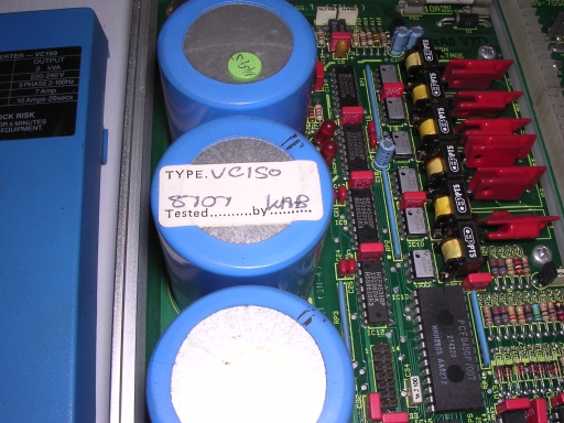

The cover on my vfd is missing so I took pictures on the numbers I found.
The top picture have the pin on 1,5kW, but I dont want to by an 2hp motor until Im sure.
/Jim

Have just pulled my old VC-150 out
First thing is that there doesn't appear to be any marking on the board as to its model or capacity BUT on my unit, and in the one whose photograph you included, the is a paper Quality Check label affixed to the top of one of the capacitors and that bears the hand-written model number.
Your unit is, I think, later than my VC-150. The inspection date and inspector's initials are marked on the paper label and in ink on the board (at least in mine). My unit bears " 87-07 " which I had interpreted as likely to mean July 1987 - but since yours bears " 90-26 " maybe its the week number that follows.

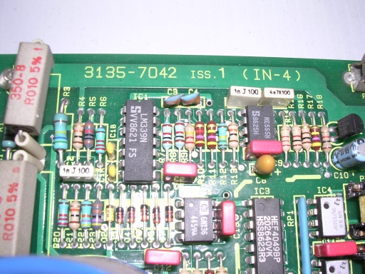

Have been over the board itself - nowhere else can I espy a definitive "VC-150" other than outside black label and the paper QA label on the capacitor. All my PCB nos. are subtly different to yours....
On mine, the board with the output amps/KVA jumper is the daughter board onto which the optional braking resistor is connected (the big fast-on terminals), so I don't know if the jumper is just on there for convenience? or whether it relates to the brake? On the big photo you posted, and in the close-ups of yours, it looks as if the daughter board has been eliminated and its all one board?
What I would do is carefully pull the jumper off. Have just done that on mine and there is a clear difference between the shiny pins where the jumper just came from, and the other slightly-tarnished ones. If you can see a clear differentiation, and you know the drive came from a previously-functioning piece of kit, then I would think it is likely to be a drive of the capacity as per the jumper.
What I would then do, before buying a motor, is to power it up in a safe place to make sure it doesn't go pop ......

I found a paper label today, it was located ontop of one of the capacitors
So it should be a vc130? And max 1,3kW?
/Jim
Re: IMO Jaguar CUB for ORAC
to be honest, I've never heard of a VC-130 - but yes, if its a VC-130 then 1.3kW looks right. Do you know anything of its provenance? It may be worth dropping IMO a line to ask - you never know, they may be forthcoming! and your detailed photos should help.
Good luck / Dave
I think the 3 is a poorly written 5, especially when you look at the other written numbers.

yes, to be honest, I think Admin is right - the idea that it should say VC-150 instead of what looks like VC-130 did cross my mind and that was partly what I was hinting at in that I couldn't find reference to a VC-130 anywhere online either.
I would be pretty sure its a VC-150 ....
In case it helps, attached are a few pictures to match yours of the Denford-fitted VC-150 that was on my Senior 3C CNC mill (which I suspect is a slightly earlier edition of yours - my VC-150 is QC dated 1987 which ties in with my mill's 1987 date of manufacture).
cheers / Dave

IMO Cub VC-150 p1.jpg (142.27 KiB) Viewed 20072 times
IMO Jaguar Cub VC-150 VFD - model label on top of main phase capacitor
IMO Cub VC-150 p2.jpg (168.08 KiB) Viewed 20072 times
IMO Jaguar Cub VC-150 VFD - main PCB number
IMO Cub VC-150 p3.jpg (175.62 KiB) Viewed 20072 times

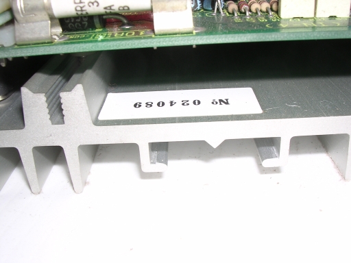

IMO Jaguar Cub VC-150 VFD - ser. no. on heatsink, under top of main PCB
IMO Cub VC-150 p5.jpg (95.33 KiB) Viewed 20072 times
