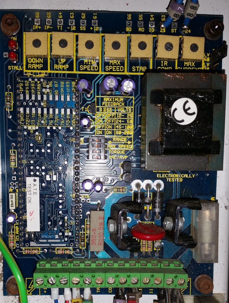

I don't use my mill commercially, but I'm am concerned that it is safe. Concerned by your post, I went and made some measurements. with the machine off and isolated I measured the resistance between 0v and earth and it is effectively zero...so they must be connected somewhere. This is not something I have [deliberately] done.
I have the Sprint Electric spindle motor controller which I believe is pretty common on Denford machines. I measured the voltage across the 0-10v input which varied, as you'd expect, between about 0 and 10v across the speed range. Since the Gnd appears tied to earth, that side of the electronics is not exposed to more than 10v. I have the "Product Manual" for the Sprint drive but not the schematic so can't be sure how/if the 0-10v feed is isolated from the rest of the high voltage side, although a glance at the circuit board doesn't give me confidence. Photo attached.

Try measuring the voltage between the earth and 0V with the machine powered up.
Chances are there will be components linking the two, which can affect resistance measurements, and the only real test is with it powered up.
Also try measuring between Earth and the 0-10V input to the Sprint board.

Measured voltage between earth and 0v sprint input with machine running...measures at a few mV. Between earth and the 0-10v line I get a few volts (as you'd expect).
I notice that the stepper board is earthed (not by me) I wonder if this is connected to the gnd plane on that board.

You're spindle controller input must be at low voltage, which certainly isn't that common.
As long as everything works how it should, I wouldn't worry about the gnd/0v connection. I'd have to go and look at the wiring diagrams, but I'm aware that original wiring has all the Earth/GNDs separate from the 0V, although they may be connected at some point. Machine earthing/grounding can be quite a complex subject, but the main jist is you avoid anything having more than one ground return, otherwise you end up with a ground loop which can be a major source of interference.
However, as Denford use 12/24v controls, it's a much lesser issue than machines that use TTL/5V controls.

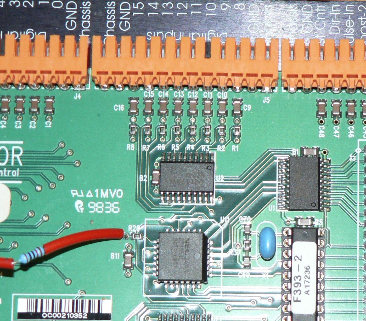

This is definitely a timely thread for me. I'm "upgrading" my novamill to run on a Chinese USB CNC controller card and finally got round to testing the spindle yesterday. Everything except 24v supply and the spindle drive signal is opto-isolated and interfaced via the 96 way header. This has been running well for a year or so just driving the steppers as I've been using the mill as a 3D printer.
My view is that the sprint spindle control board is definitely running on a high AC voltage and the speed demand pins are coupled to it in some way. Whilst my USB CNC 0-10v spindle output has survived the ordeal I'm getting the board crashing at greater than half speed, I suspect because of 50hz noise feeding back up the sprint demand line and an associated relay on the USB cnc is ticking nicely at about 50hz when the spindle is running.
There are a pair of axes demand pins on the 96 way header according to the denstep card manual, does anyone know if these are for sending the signal from the control card via the back plane (with some filtering / isolation hopefully) out of the normal back plane to sprint connections?
Otherwise does anyone know of a way to isolate a variable 10v signal line between the two cards? I'm an electronics hacker so no in depth knowledge here unfortunately.

See this thread viewtopic.php?f=54&t=5051- post of 31st Jan and the link provided on how to re-use the optically isolated 0-10V (actually 0-11V) out from the Denstep board.
The PWM doesn't go via the 96 way header - you can do what is shown in the link, I soldered my current limiting resistor into a through hole on the Denstep board (follow the track from R29). See image - but note the resistor shown is incorrect value, and I hadn't yet removed R29 (surface mount) from the Denstep board.

OK that looks great and the linked information has sent me in an equivalent direction.
I have a few more of the opto-isolating boards left (I bought a job lot from China) so will isolate digitally from a PWM spindle signal (the controller can do 0-10v or Radio Control PWM) then use the +10v and ground on the sprint to drive that side of the isolating board and add in some signal conditioning to get the full 0-10v range. Think I finally need an oscilloscope... ;-)
