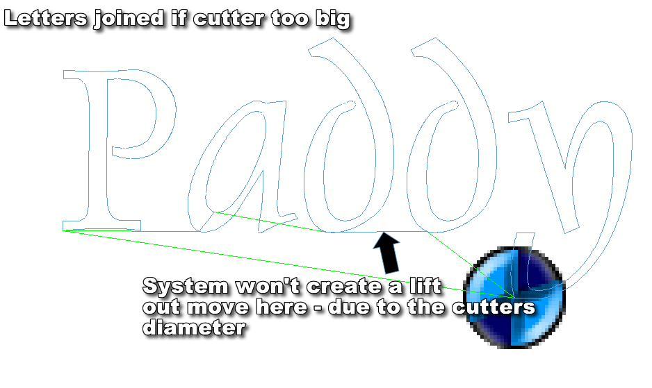

This picture highlights how the tool will not be lifted out between letters, if QuickCAM thinks the cutter is wider than the gap between the letters
How the text should look - after using a small diameter cutter in the Follow Machining Plan
