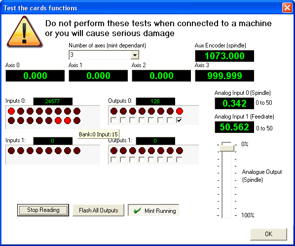

If the switch and wiring is fine, then I'm guessing that the home input has blown.
You can try the latest EasyUpgrader which now has I/O monitoring functions (you will have to email me to get the password)
That way you can connect a test button and wire straight to the Z home input and see if the button changes the input state.

Problem is in the top card, anyway to correct this?
Sounds like the input chip is shot :( It will require returning for repair.
