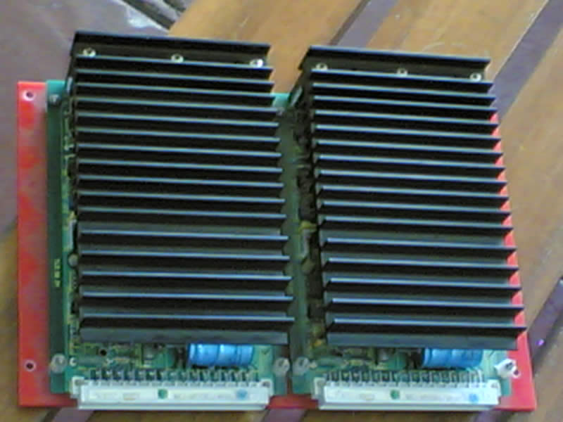

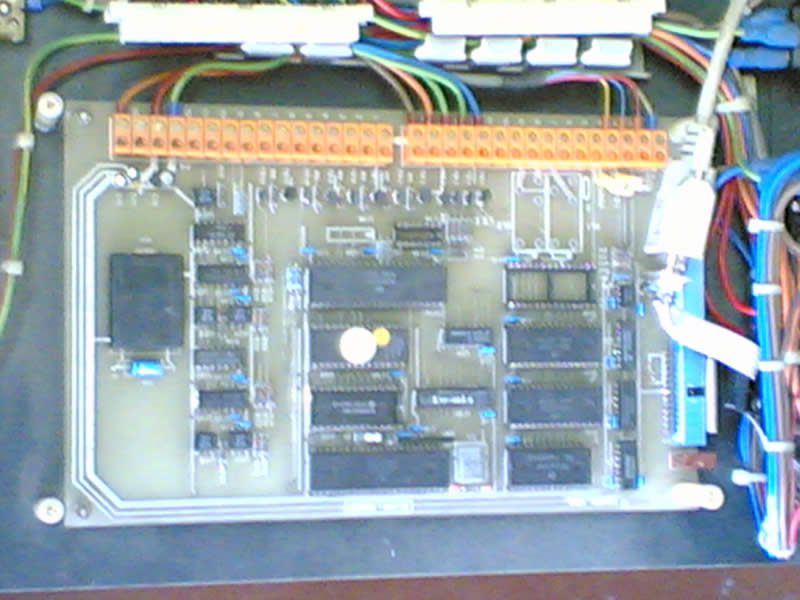

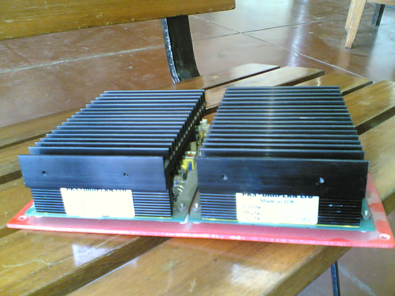

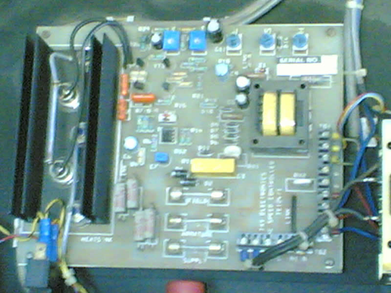

Would like to know the functions of the following parts dc speed controllers, slave board, and bus board. i would also like to know if the RS 232 serial link can be change to universal serial link.

If you could attach a photo of the machine and the electronics, we may be able to help find more information
You would never get the machine working with USB as it is - you would have to retrofit it with some new CNC controller and PC software

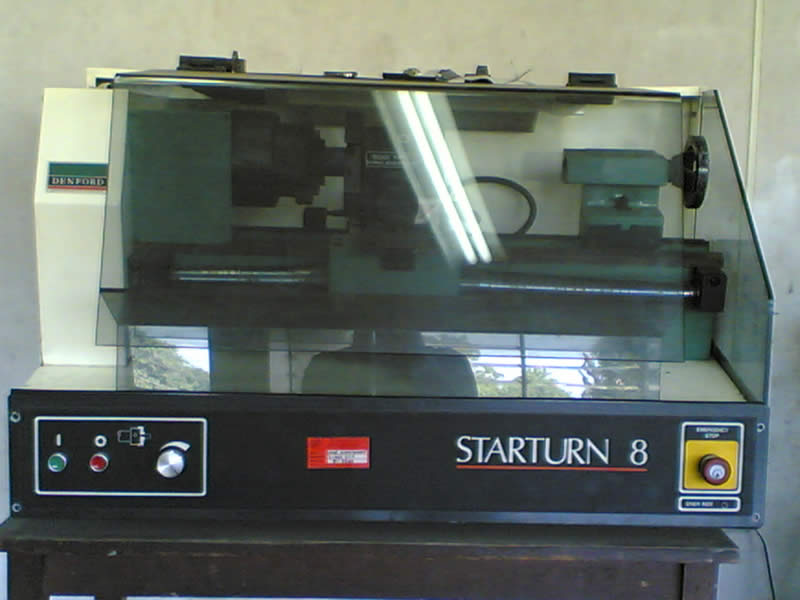

We can do our best, but I'm afraid we can't just wave a magic wand and get your machines working :!:
We can no longer officially support this age of machine - most of us here have never seen a Starturn 8, let alone used one.
We can help with general advice and how other forum users have upgraded their machines to use windows based software, you really need to investigate the best way to get them working for yourself.
