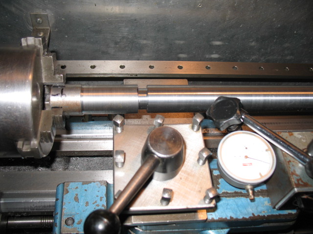

The hard part is setting the taper angle. For 4" travel, I need 0.1" offset. The photos show a DTI mounted on the top slide. I am using my parallel test bar to measure and set the right angle on the top slide. The parallet test bar provides the reference I need to get the morse taper right.
Setting the correct angle is going to take a bit of effort. Tightening the top slide clamping screws rotates it a little, so it's back to the measure, loosen, adjust, tighten, measure cycle. I have found that it helps to tighten and loosen the screws in the same order.

Showing the parallel test bar with a groove cut to locate the fat end of the morse taper.  The depth matches the fat end diameter.  The DTI is mounted on the top slide and measuring offset from the parallel bar.
