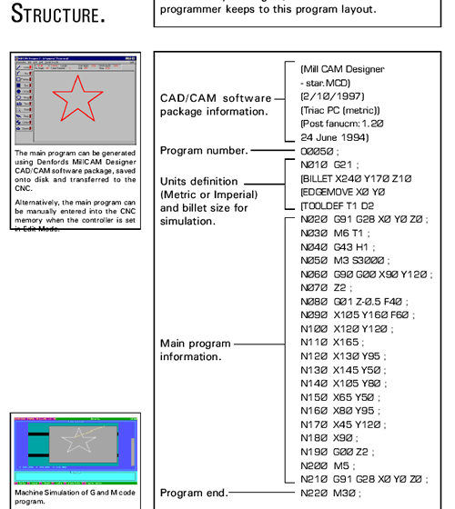

To give you an idea of whats in this PDF:
The screenshots are from the DOS operating software and MillCAM designer from the late 90's early 00's
