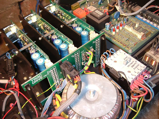

So, i've managed to establish that the reason that the toolchanger wasn't working, so far that is, is due to it's supply coming from the Main Contactor located at the side of the Drive boards which wasn't being energised.
When I first got the machine fuse F1 was blown so I have replaced that and also checked all other fuses are ok.
To eliminate a faulty Main Contactor I powered up the machine and then 'made' the contator by pressing (with insulated screw driver) the grey button on the top of it.
When I did this the green LED, just visible in the pic between fuses F1 & F2, briefly lit before both fuses were blown. On the up side power was supplied to the ATC control, main PCB, and spindle DC motor control board. I appreciate at this point I ain't going to get drive to the axis but I pressed the ABS Datum button on the machine front panel. The machine then displayed that it was moving to Z datum, which obviously it wasn't as the drives had fused. I removed my screw driver from the Main Contactor and powered down the machine.
So, looking at the Drive Cards nothing looks too obviously wrong but it took out the fuses so something must be up.
Appreciate any advice ...again!
Thanks ...Richard
I'd suggets removing the 3 x Digiplan axis drive cards, replacing the fuses then powering up again.
If the fuses stay good then start adding the cards one by one (powering down in between!!!) to see which axis has the fault.
If you find a faulty axis it could be the card that's faulty, or a short on the motor output cables (I've seen a z axis stepper motor cable get trapped inside the column and short out before now).
You can temporarely interchange cards to check if it's a faulty card, but make sure they finally end up back in the right place (becuase the Z axis has a 3 amp card and so a 2 amp card in this slot will give you Z axis stalling problems further down the line)

only wish it was a dicky pin on the plug but I think it is one of the cards!
Swapped over the X and Y cards and that reversed the problem. Checked the surface mounted fuses on the suspect card and they were ok.
Tricked the machine into thinking the faulty axis had datumed and everythin came on line ...even the ATC!
