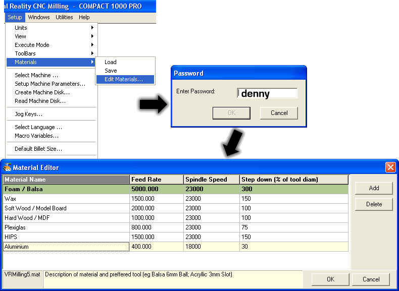

See the picture for how to change material settings.
In this particular material file, the entry for Foam/Balsa is set to 300% step down.
This means that if you are using a 6.35mm cutter and choose Foam/Balsa, the dxf import will allow the cutter to go down in Z by 19.05mm each pass (6.35mm Diam * 300% = 19.05mm)
If you have a soft material that can be cut in one go, then add a new material and set the Step Down to say 500% for example.
