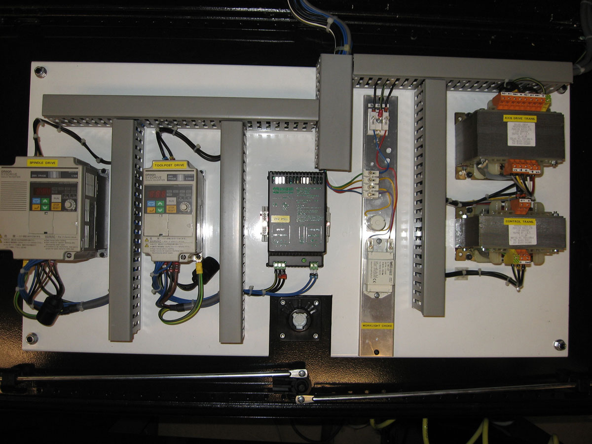

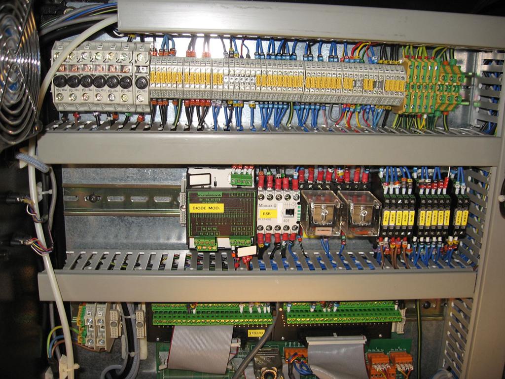

If you have the drawings for your machine, and a photo of the electrical cabinet, it would help me in finding a solution.
CalU MIRAC Photos.
I have some wiring diagrams here in Medina, not sure if there for this MIRAC, they could be faxed.

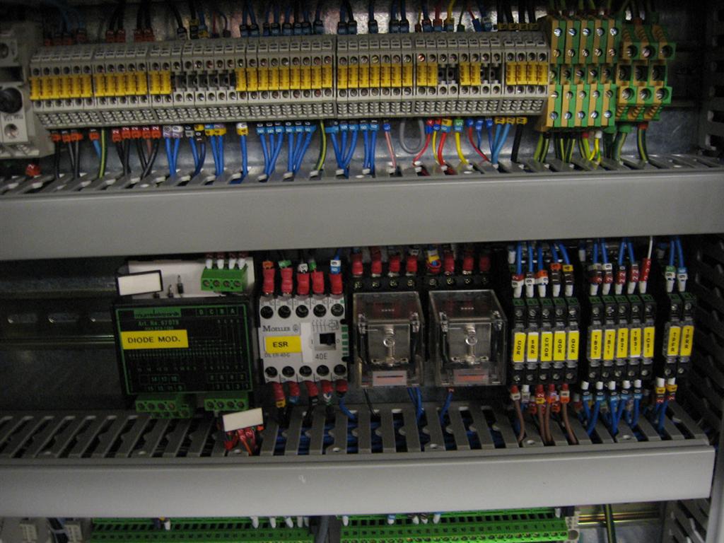

That is a very similar layout to the problem I saw on a old Triac before.

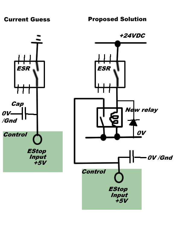

The Emergency stop signal looks like it is going through the white Moeller ESR contactor - probably the thin red wire at the top, blue at the bottom. Either the red or the blue will go down to the green terminal block.
I think the problem is down to the fact that its using a big old contacts to switch the 5V signal to the control, and that these wires are located right next to the other ESR contacts which are switching the suppply to the spindle.
If I remember correctly, I had to wire up another smaller relay (a quality one with low voltage contacts) to be driven from the ESR contactor, then use this new relay to switch the 5V ESR feedback into the control. (this new relay wants to have a higher coil operating voltage - choose either 24VDC or 110VAC)
See attached "sketch" of what I think will fix the problem...
Please double check I have got the input voltages and relay wiring the correct way round as I have done this blind 8)
The E-stop relay shown has a 24v coil so the diagram shown is not the solution. :(
Perhaps the drawing was a bit misleading - I'm trying to show a new relay being driven from the contact that currently goes to the estop input - nothing will change with the wiring to the original 24v coil :?
ie, remove the thin ESTOP feedback wires on the old contactor, and use that contact (now spare) to energise / de-engergise a new relay with low voltage contacts
I'm sure this would be a better and longer lasting solution, than replacing the current ESR contactor with a new one, which may again develop the same problems
The diode you show going across the New Relay, Any particular value for 24v or 110v or 220v coil??
If you are getting a relay with and AC coil, you will need to fit a Resistor/Capacitor (RC) suppressor
If you get a DC relay coil, then you can probably get one with a flyback diode already fitted - the part number normally has an extra D at the end of it. Otherwise its a normal 1n40 diode
we normally use a 1N4003 or 1N4001.
