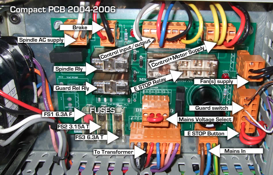

Take the side panel off the compact, locate the printed circuit board with RED LED's, fuses and relays. Locate the relay with 3 contacts on it (Usually long and rectangular) Manufacturer SCHRACK. Press the Emergency Stop button and note whether a 3 contact change state, if they don't, check that the RED 1mm cables to the back of the Emergency Stop Button are connected correctly and that they are properly located into the bottom 2 terminals on the 6 pin socket on the bottom Right Hand side of the printed circuit board with RED LED's, fuses and relays.
This picture of the compact distribution / relay pcb board should help clarify what you are looking at:
Compact distribution relay board 2004 to 2006
