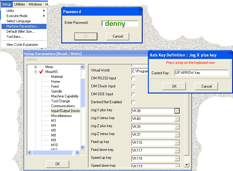

Are the axis position numbers on the screen changing when you are trying to jog ?
Also double check the parameters defining the jog keys have not been tampered with.....
You can change the jog key definitions in here

In all versions of VR Milling and Turning, the Jog mode has to be selected, and there will be a green indicator to say that its able to jog.
If you click on another window the Jog control panel looses focus and you aren't able to jog.
It could also be down to feedrate override - the system may think you have an external override pot fitted where there isn't one - resulting in a permanent override of 0%.
Usually the default parameters are correct, but some machines can be different to the default.
Are you sure the jog keys are changed to what you wanted ?
Remember that each machine you have tried will have its own setup for the Jog keys
