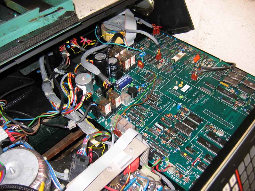

I shall rebuild my triac 1986 to Mach 3. I wonder how the Boost and Energize control signals are used to the stepper board.

I presume they are SD2 and SD3 drivers? If so then -
viewtopic.php?t=561
Look at pages 35-37.

yes its the screen drive card. it looks like it has a carrying handle over it.
