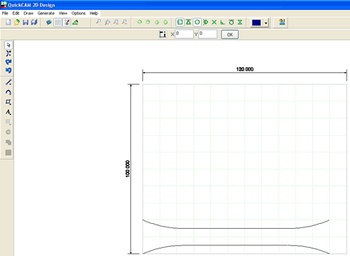

The first thing I notice, is that the DXF file contains multiple lines/arcs on top of each other.
These additional ones should be deleted, to avoid confusion later on....
Imported DXF file into QuickCAM 2D
Multiple overlapping lines and arcs

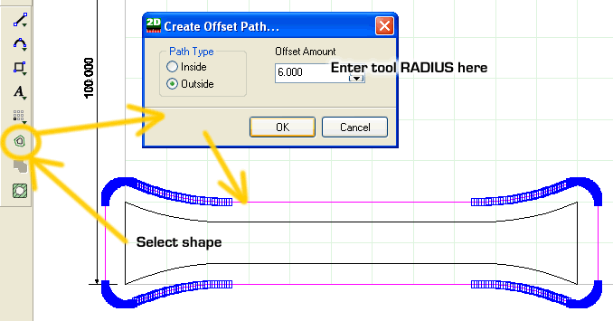

It would be possible to now go to the CAM wizard, and create an offset path, according to the selected tool diameter.
Because you want to implement varying offset cuts, then it may be easier to create the offset paths within the CAD part, and simply use the Follow machining plan.
You will need to know the diameter of the tool you intend to use.
Select the newly joined shape, and create offset paths of different amounts (remember to enter the Radius of the tool as the final offset path required)
Creating an offset path

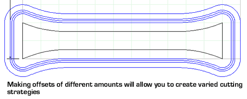

Now, create any additional offsets in the same way, so that you can create rough cuts, then a final finish cut that is not removing much material...
Adding more offset paths

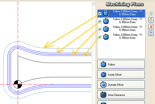

You should now be ready to create the G and M code program
Goto the CAM wizard and create multiple FOLLOW plans.
If you create one plan, and select all the offset paths created, then you cannot guarantee which order the paths will be machined.
Createing seperate plans for each path, gives you full control over the machining order - the plan at the top of the list will be machined first, then the next, etc....
Create individual plans for each offset path created
