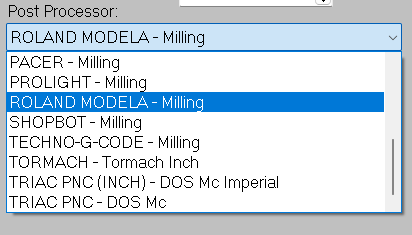

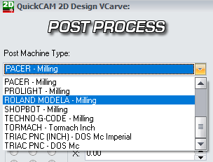

Both QuickCam 2D and QuickCam Pro have the Roland Modela as an option in the post processor output.
Screenshot 2025-10-27 165644.png (20.78 KiB) Viewed 2483 times
Screenshot 2025-10-27 165543.png (10.47 KiB) Viewed 2483 times
Re: QuickCAM and Roland (MDX40)
Hi! Thank you for your reply.
These options generate a .ROL output file.
VPanel only accepts: .RML .PRN .NC .NCD. NCT and .TXT files
I have tried changing the file extension to see if if that would work, but no success.
I don't know enough about Post Processors to know how to convert it.
