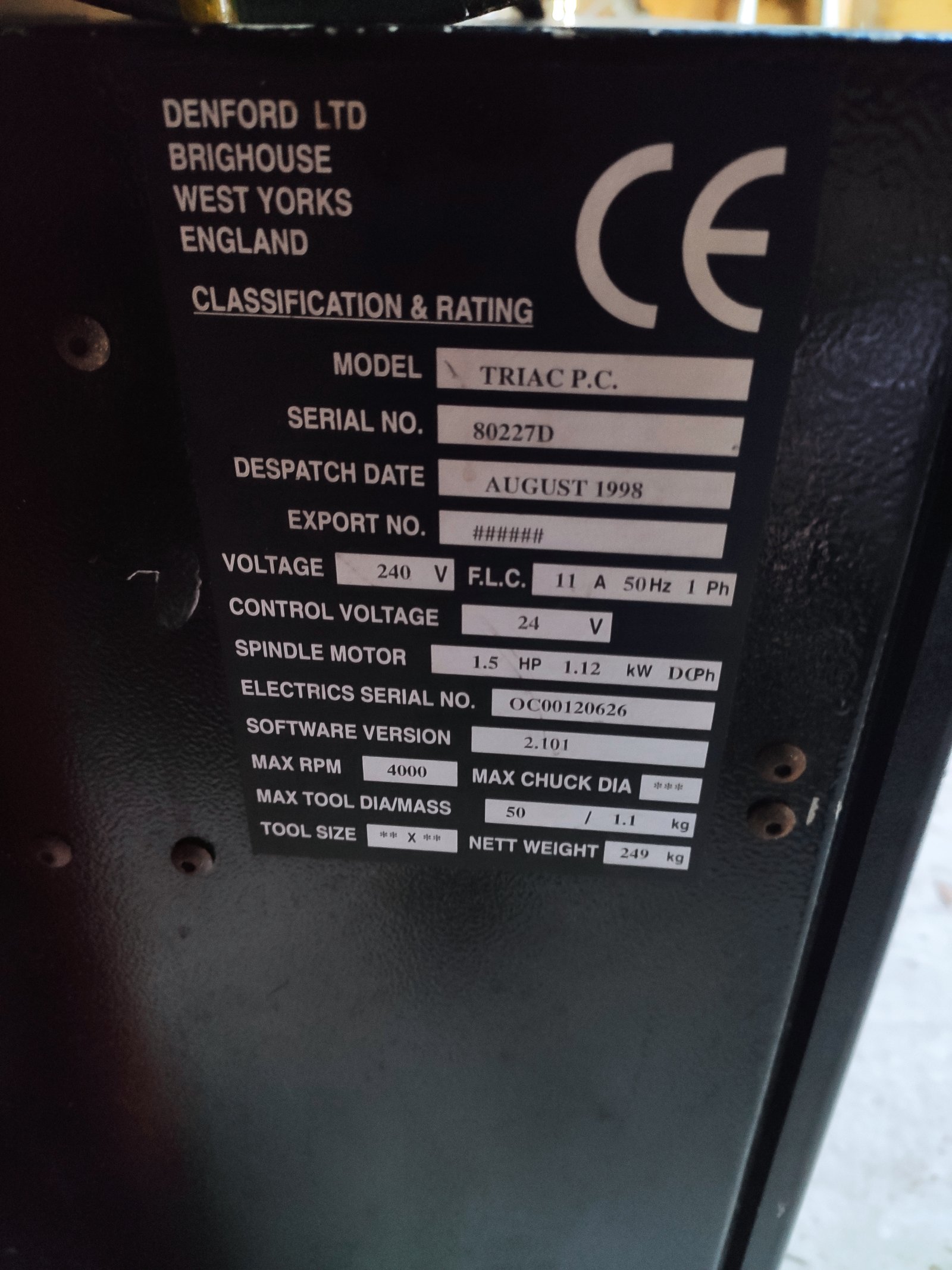

Hi, I'm trying to figure out what taper is inside my Triac. It's made in 1998. It is the Non ATC model. It came with the easy change tool holder. I think they came with either an R8 or BT30 taper for the manual change models ? Pics of the tools that came with it. It looks like BT30 ?
