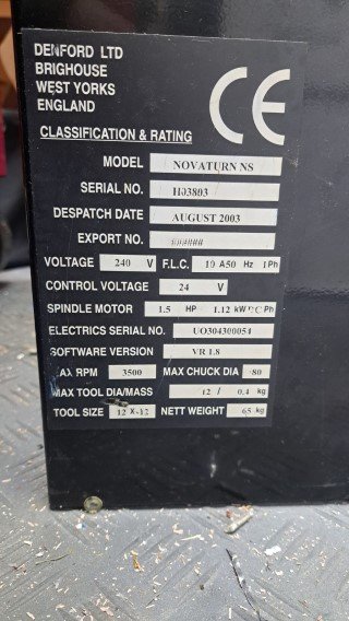

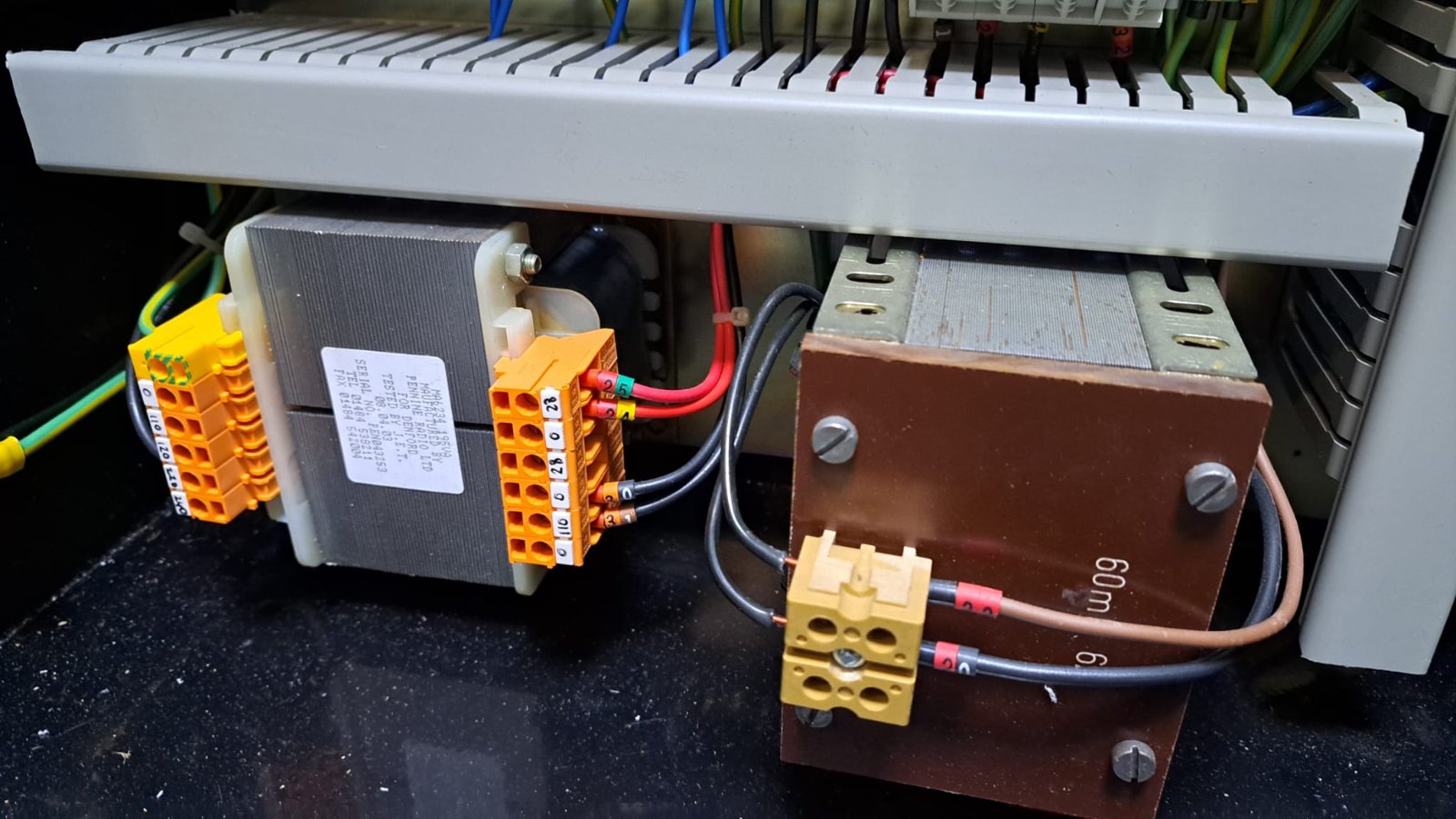

Can you post some pictures of the serial label & the control unit.

Martin wrote: ↑Mon 03 Feb , 2025 9:28 am Can you post some pictures of the serial label & the control unit.
Done.
