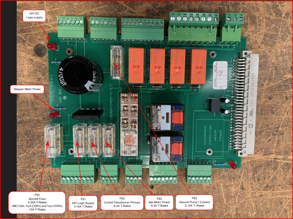

DEN 404 Distribution Board Fuses
DEN 404C Distribution Board
This card is the base layer of the DEN 2020 Controller.
DEN404C Fuses.png (1.45 MiB) Viewed 18169 times
