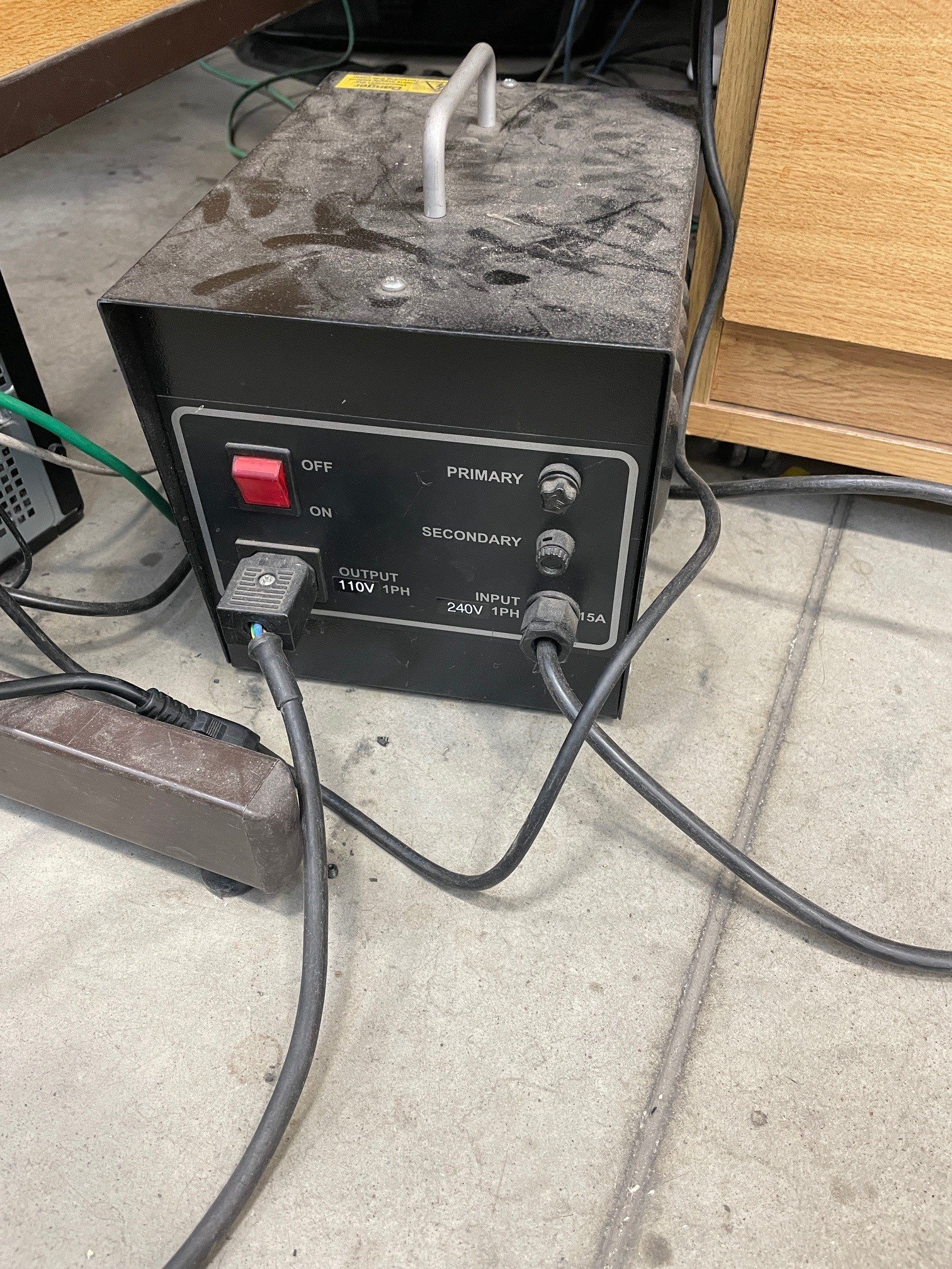

I am trying to power on a TRIAC VMC, this machine has been without use for some years now. It is installed in american continent where most of the power is 1phase 110V + 1 neutral; or 2 phases each one 110V (this is our 220 Voltage), and frequency is 60 Hz.
From the dataplate I noted the following:

The machine was probably supplied with a seperate autotrancformer in a box. this would convert the 110V to 230 or 240V.
Re: Using TRIAC with America voltage 110V 1ph, or 220V 2ph
:D Steve, thanks for advising. I Will look fornthis Transformer, this should be somewhere among the equipment componentes.
