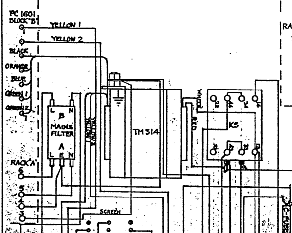

Hi, I Made a big misstake when I disassembled my ORAC. I was sure that I didn't need this part, the PC1601 its the "rectifier board" for 24v and 12v. But now I know bether. =)
From my transformer I have two green cables, two yellow, one blue, one orange and on black.
Could it be possible it should be mounted in the following order:
Green
Green
Blue
Orange
Yellow
Yellow?
/Jim

The drawings do show this TX - check the downloads section
This may help......
