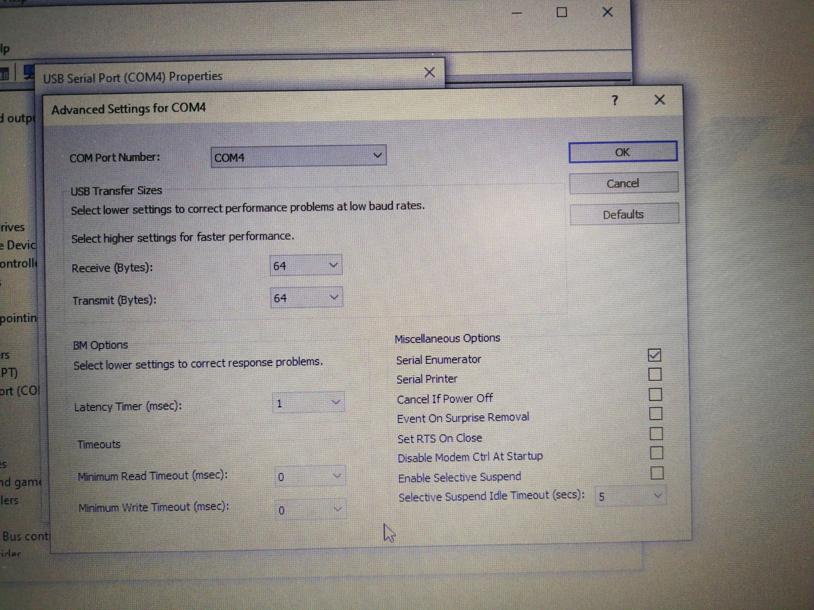

It still refused to communicate so I looked a the advanced settings for the COM4 port and changed RX and TX bytes to the minimum 64 and set the latency timer to the minimum value of 1.
Success!!! :-D
I've added the teaching keyboard using another USB->DB25 converter and tried a quick three tool engrave in a block of wood.
One Novamill with ATC now up and running again. My to-do list includes looking at the ATC and fine tuning the stop position and index rotation to minimize the catching of the tool as it's returned to the pocket. I will read up on the serial driver and look to disable the selective suspend.
My current com port settings attached
