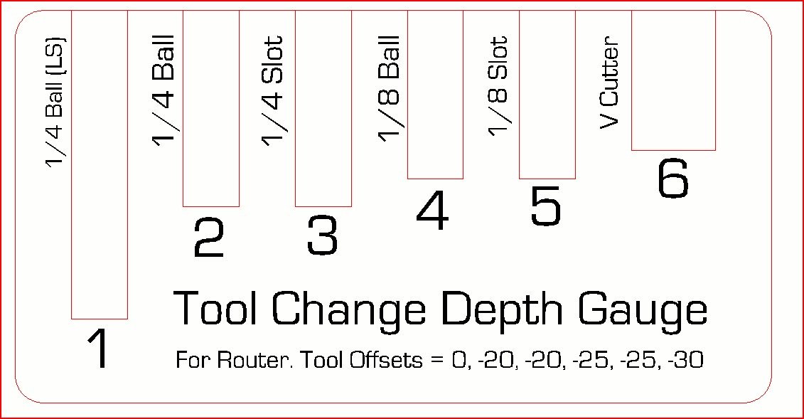

A usefull setting gauge for router tooling if not using the recommended tool holders.
Set tool one on the surface of the material with a Zero offset and other tools have an offset of either -20, -25mm or -30mm.
