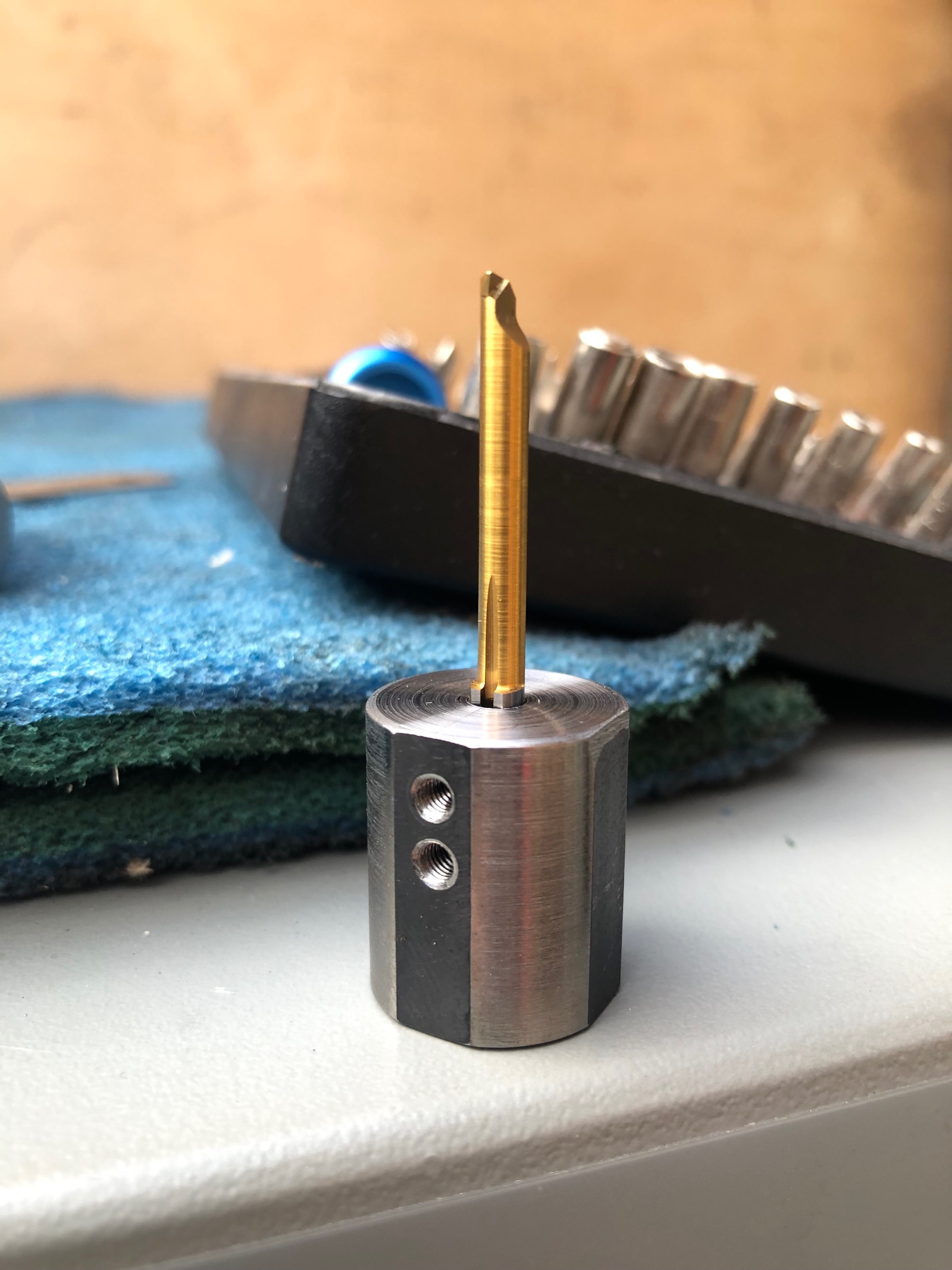

I've programmed the Micro Boring Bar info into the tool library and managed something that looks approximately correct. The tool is 3.5mm Dia at the cutting tip (.1 radius tip) with a long shank so plenty of clearance. The bore is 10.5mm (10mm drilled hole) stepping down to 6.4mm (6mm drilled hole), with a .5mm radius on the corners.

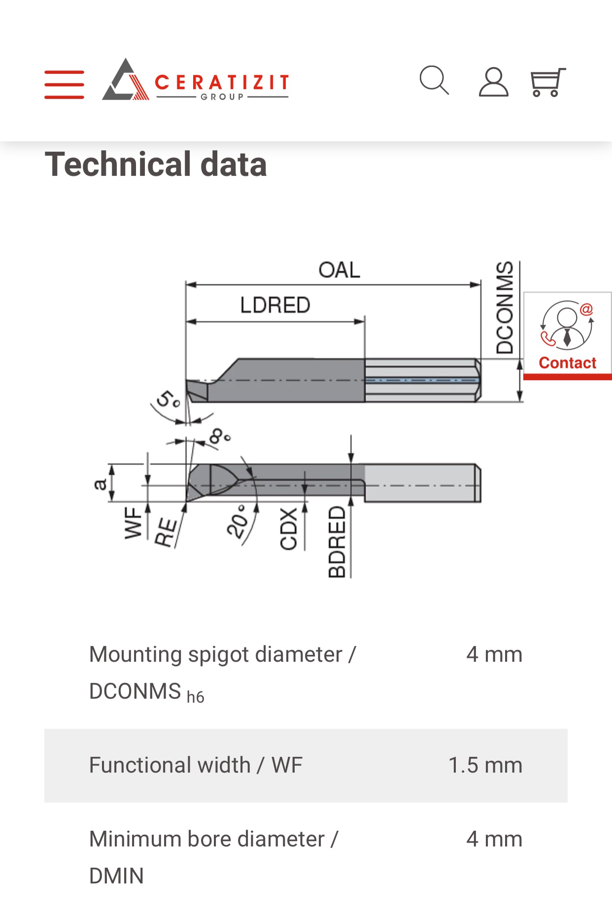

This is the data I used for the tool. Can’t take a picture of the data on the PC as it’s down awaiting a new GPU tomorrow.

ok no problem. I entered the data from the tool into QuickTurn2D, as you stated it cannot go down into the smaller bores.
What I did was reduce the value of f to 1 (WF on your datasheet). Theoretically this should just reduce the size of the cutting face. This change does allow the tool to now bore down to 5mm.
I would also reduce the cut depth in the materials library to 0.3mm (currently 0.4 and 0.5mm Fine / Rough).
Watch the machine very carefully on the first cut to ensure it doesn't do something unexpected though.
