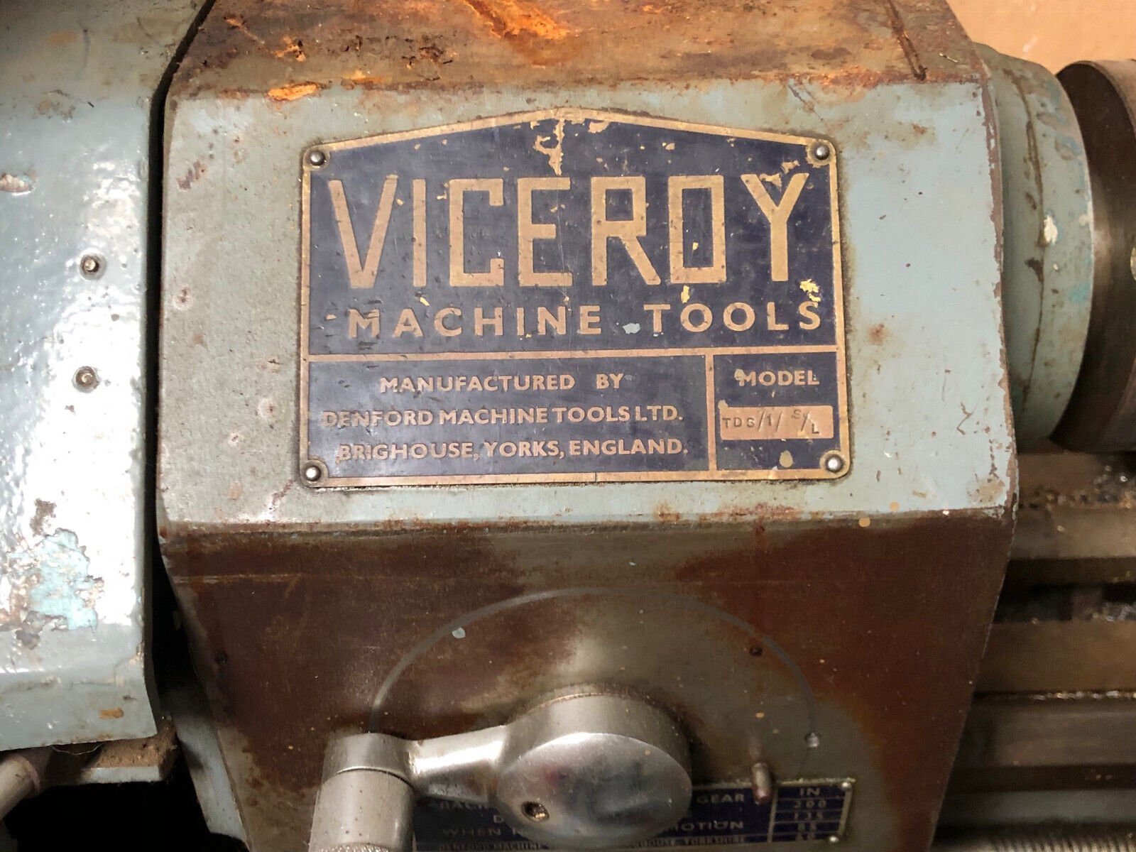

So once again, it's Happy New Lathe Day to me (HNLD!) as I've just been to collect a Denford Viceroy TDS 1 S/L - so that now makes 2 Denford Viceroy TDS1's sat in my garage - whoops!
It's slightly different to my other one though - different headstock area, different main bed and different main apron. If anyone can shed any light as to which Mk they are (if such a thing exists) or which is newer, or which is perceived to be better - I'd be very grateful.

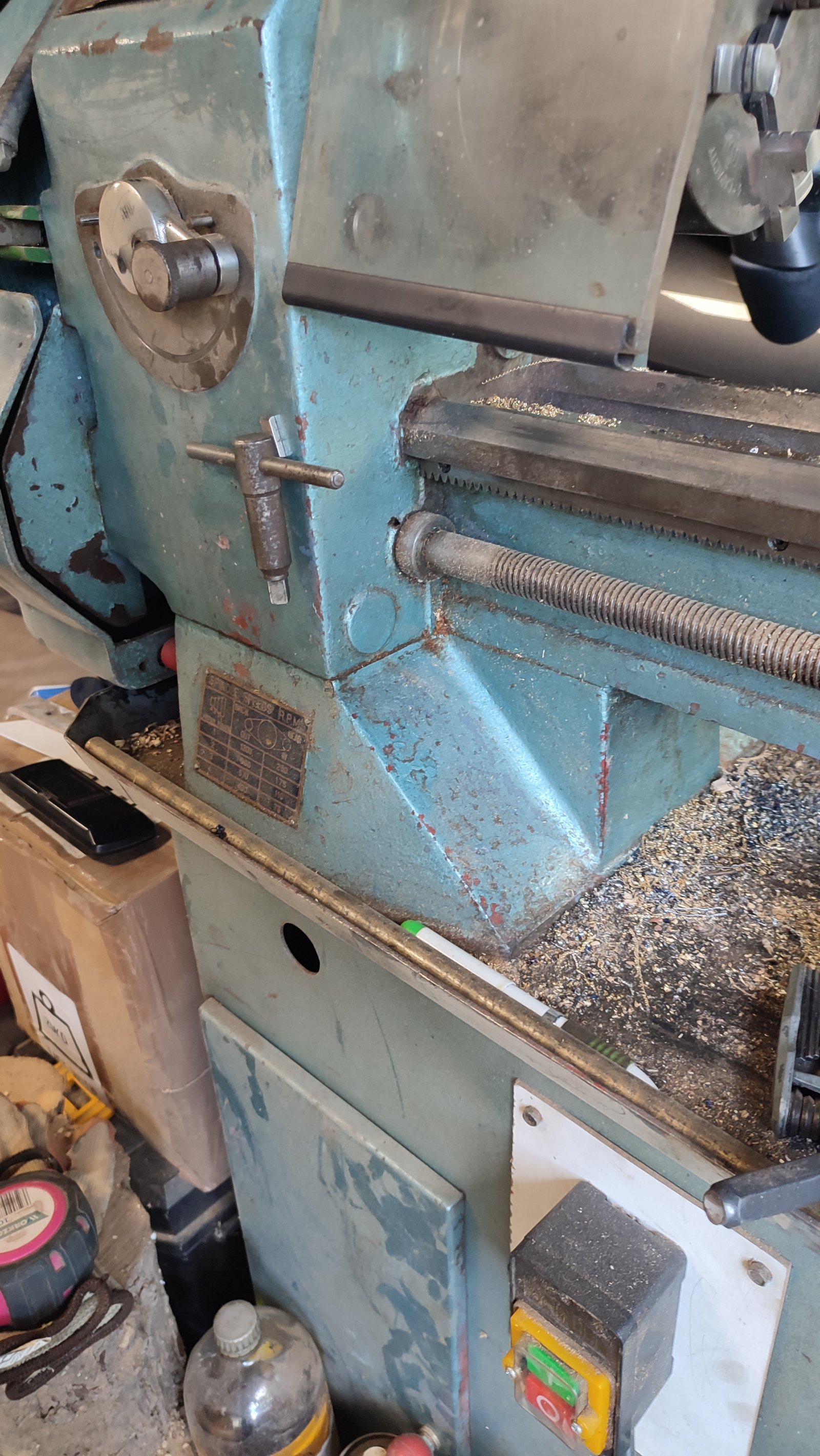

My other TDS 1
TDS 1 S Headstock area

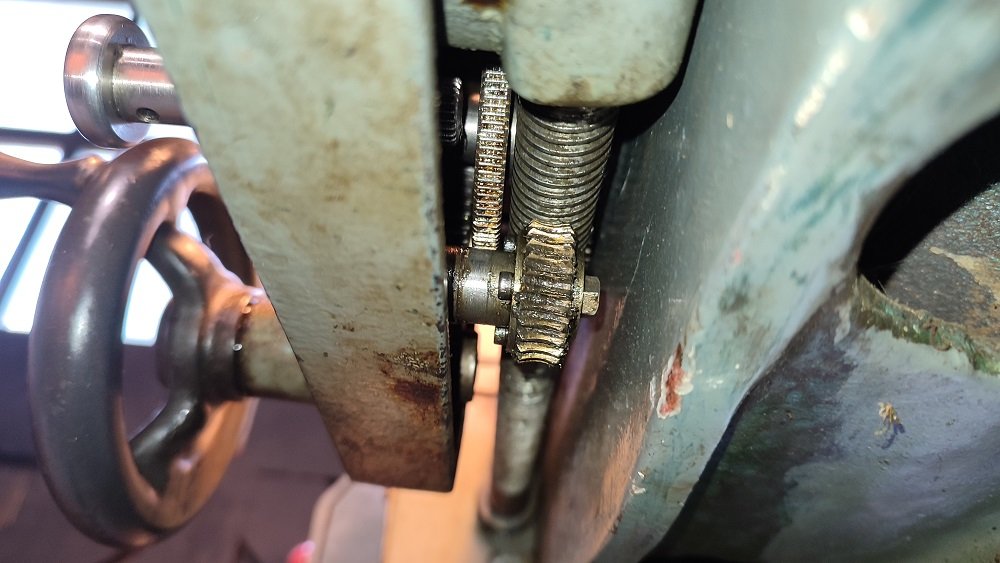

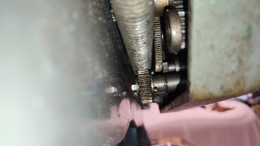

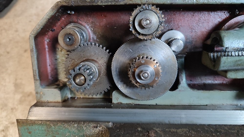

On the TDS 1 L/S apron, there is a push in / pull out knob that engages a small (10mm dia?) fine toothed gear with a larger fine toothed gear (100mm dia?) that then drives a gear whose pitch links into the leadscrew. There is a corresponding gear below that one which also interfaces with the leadscrew. Other than the leadscrew, they don't seem to link into anything else. These gears are held in place (and adjustable) by the 2 screws (held in place by locknuts) lust to the left of the knob. When the knob is pushed in, I can't turn the main travel handle in either direction (I've edited this post since first writing it to update this bit). I've not been brave enough to drive it with the leadscrew under power so far - until I know what it does or should do. There is no gear linkage of any shape or form onto the cross slide, so I know its not a powered cross slide, but if I have a frankenmonster of the front part from one machine and the top part from another machine - that might explain it perhaps? I'm not getting confused with the powerfeed lever - that's the one on the right of the saddle and works fine and as expected.

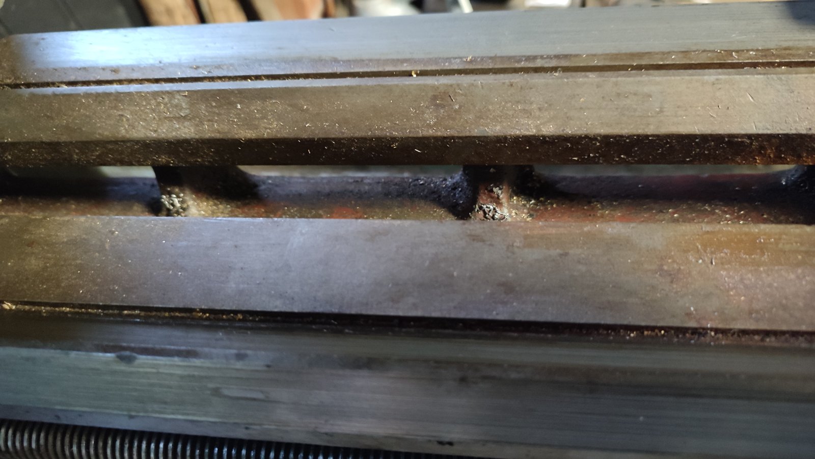

On the main beds, the new (to me) bed has a slope which encourages the swarf to fall to the rear, whereas on my 'original' one, it has a slots / holes all the way through, so swarf will simply fall downwards.

I have attached a brochure copy from about 1978 which seems to cover your lathe type, not sure of exact date as its not marked. Mine TDS1GB is from about then but has a square shape to the headstock - not sloped off as in the pic - if yours is 'squared off its a later lathe and yes mine has sloping slots in the bed.
It had power feed longitudinal and manual cross feed.
The knob you ask about appears to be for cross feed - it is pushed in for longitudinal feed and pulls out for cross feed - (mine is a different layout and the rod is push/pulled by a lever as I have a gearbox mode)l, which when direction is selected operates the feed by the lever you note.
So maybe yours is a hybrid ? Denford do seem to have numerous models though.
Have you looked at the Lathes.co.uk website as that covers the Viceroys quite well.

Ref the knob, ordinarily I'd agree, but sadly in this case it appears not to be so. I would have expected a lever as that's what I've seen in other pictures of the Viceory Lathes. My 'knob' has a keyway in it which prevents it from rotating and it is affixed to the apron with a large securing nut, again preventing any rotation. The small fine gear on the end is also securely attached, it does not rotate on the shaft and there is no provision for it to do so (no circlip preventing it from coming off, no securing grub screw etc). I've attached a few more pictures showing the arrangement.

Vertical view of cross slide showing 'drive' gear (not currently able to be engaged to anything) blocked by apron casting
Reverse view of apron (upside down!) with knob pushed in
Alternative reverse view of apron with knob pushed in
Tailstock end looking to headstock showing vertical alignment
Underside of apron looking towards headstock
Underside of apron looking towards tailstock, knob pulled out - gear not engaged
Underside of apron looking towards tailstock, knob pushed in - gear engaged

I think the knob may be the longitudinal feed engagement, when in it will prevent the gear running against the leadscrew from rotating from what I've read and seen so it'll be drive the carriage along the bed. The lower gear appears to be an idler to support the leadscrew preventing it from flexing away from the upper gear when loaded.
Re: Happy New Lathe Day (Part 2!)
Thanks for replies. It's not for the longitudinal drive engagement (tailstock to headstock or vice versa), that arrangement is the right hand most lever and split gear arrangement. The gear arrangement I have does not engage with anything except itself. I'm aware of the cross slide feed from these 2 threads:
viewtopic.php?t=450 - Apron stripdown
viewtopic.php?t=449 - Apron reassemble
My 'unknown' gears are a much finer pitch than those used in the cross slide system.
All it seems to do is lock the travel in either direction. I do have a carriage lock on the right hand end of the apron (easily visible in one of the above photos), so I'm 99% sure it is not a second system for locking the main slide (far too heavily overengineered if it was!).
I think you'll find with the knob in and fine gears engaged it's not locked the carriage to the bed but rather to the leadscrew so if you turn the leadscrew the carriage should move. As there doesn't seem to be any gearing involved it should produce the same movement as the half nuts which the lever on the right of the apron engage but due to the fine gears you'll be able to engage at far more places than the half nuts which would normally be used for thread cutting but you don't have a threading dial by the look of it so would have to keep them engaged once threading and back the spindle up. Is the lathe single phase? Is it wired to reverse?
Thanks David,
Interesting thought - you are suggesting there might be 2 ways to move the apron, one with the lever (engaging the leadscrew with the half nuts) and one with the knob (but via 2 gears, one on each side of the leadscrew to apply a 'central' force so it doesn't try to push the leadscrew away).
I'll have to have a manual turn of the leadscrew with the knob pushed in (and the gears correctly aligned - they are currently just 'loosely' located if you know what I mean).
It is a single phase motor, not wired for reverse (currently) and no I don't have a dial indicator but I'm in the process of 3d printing one. It's an imperial leadscrew (8tpi) but I sadly don't have a full set of change gears but have previously 3D printed gears that have worked ok.
Seems this is the case! I manually spun the leadscrew (through the gearbox) with the knob pushed in and yes, it feeds the main apron along the bed, so it IS just another way of engaging them main apron travel, so now I have 2 ways! I was then brave enough to do it 'under power' and yes, I can engage / disengage at will. Not sure what the benefit is, but hey, it's another option. I also now have a working dial indicator so as and when I decide I need to cut imperial threads, I'm about 75% of the way there (need a complete set of gears to be 100% there!).
