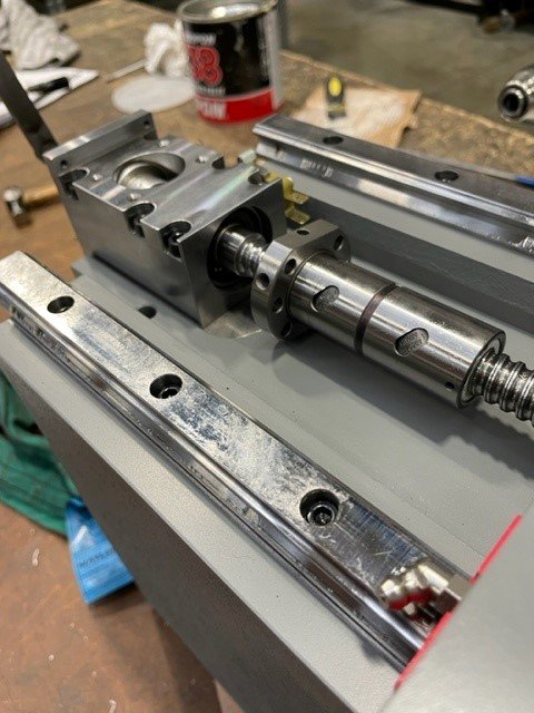

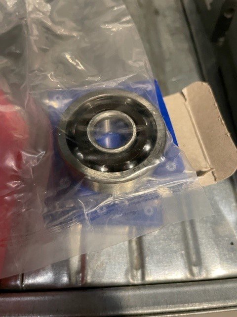

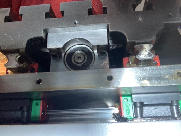

Its not easy to see so took some photos from machine assemblies. The bearings are in the same place by the motor mounts.
Re: Seeking lubrication clarity
Thanks Steve. So there is one "axis rotary bearing" per axis and it's an unshielded ball bearing at the far end of the mount from each axis motor. That should be a fun task to access those with a syringe!
They will be packed from new and will probably last for years without lubrication.

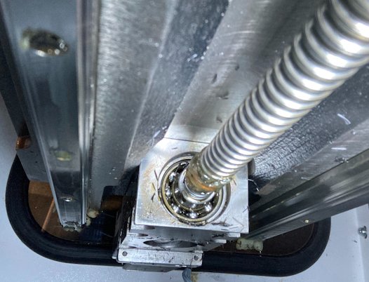

Belated update on lubrication of axis screws rotary bearings. I used a syringe on 3 bearings, the X right you can see in the pictures is sealed so I left it alone.
X Right.jpg (49.5 KiB) Viewed 13148 times
X Left.jpg (46.36 KiB) Viewed 13148 times

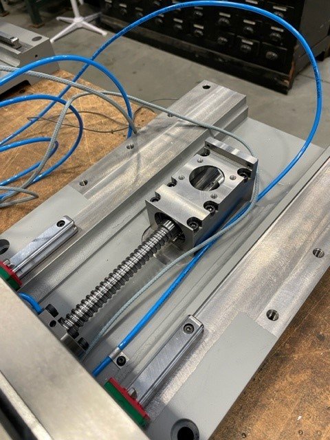

What is the lubrication schedule for a VMC 1300 fitted with the optional automatic lubrication system?
The X/Y/Z linear guideway blocks have attached oil reservoirs, and I can follow the linear guideway manufacturer's recommendations.
The X & Y ballscrew nuts are plumbed to tubing with open ends secured next to the Y-axis microswitch, under the saddle. To lubricate the ballscrew nuts, would I inject grease into this tubing with a syringe?
