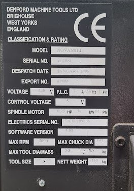

The short of it is the rated speed printed on the machine specification label is 3000rpm, my understanding is that Novamills are normally 5000rpm, so perhaps mine was limited on manufacture for safety reasons on request by a customer.
The photo isn't clear but it states:
3000 RPM
0.25 HP
.18 KW
I can near enough stop the spindle by hand at most speeds, particularly in the lower range. Presumably this is not normal.

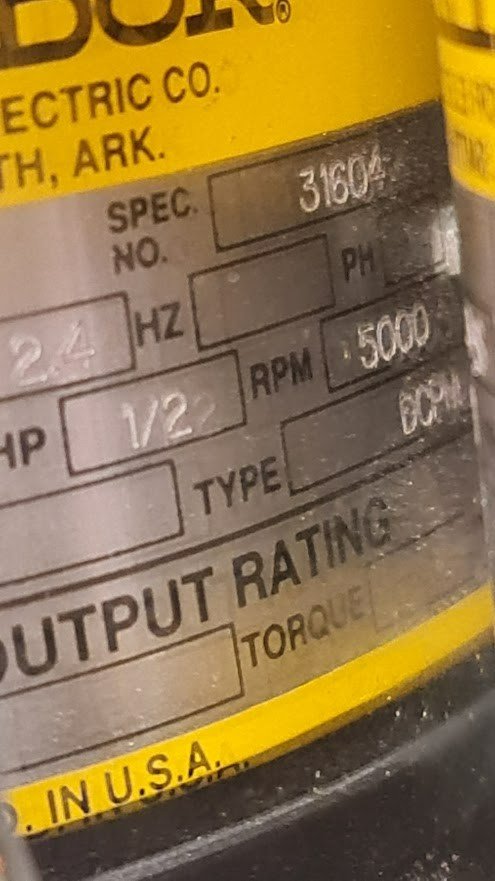

I opened the rear of the machine and checked the motor tag with a mirror and it appears to be a standard Novamill Baldor.
74-AH-0
180 DC
1/2 HP
5000 RPM

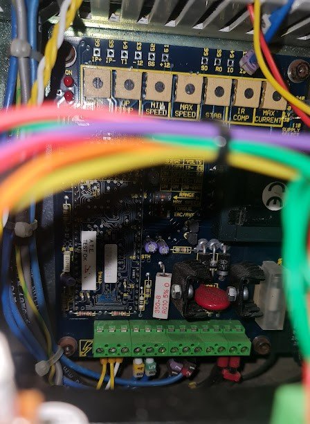

The previous owner has wired a 10K Pot into the Sprint Board on pins 1 2 &3 to manually control the spindle speed. I would prefer this to be through Mach 3 but ill address this down the road when my understanding is better.
My question is, can I adjust the settings on the Sprint board to allow the full 5000rpm from the Motor?
I understand the motor will slow down somewhat under load but at present griping it slows to near standstill. . My understanding of the relationship between torque and speed and DC motors is vague at best but id like to get the maximum performance from the motor possible. The sprint manual indicates there are torque settings, could adjustment of this give me a bit more power to the motor?

A friend came over to my workshop who knows more about cnc electronics than I and we went ahead and adjusted the Max Speed Preset on the Sprint Drive. Bit by bit and testing with a handheld tachometer we got the speed up to just shy of 5000.
The power is still a bit lacking, but a marked improvement.
Could anyone shed any light on the Torque Control and overspeed limiting?
With a pot on T64 and S3 switched on what would this translate to in a real world milling operation or is this of more use in other motor applications. Does it work in reverse as well, if the speed reduces due to load would it adjust up to keep a constant rpm? Im unclear how it knows whats happening in real time, does it need a tachometer signal or is this measured an alternative way?
