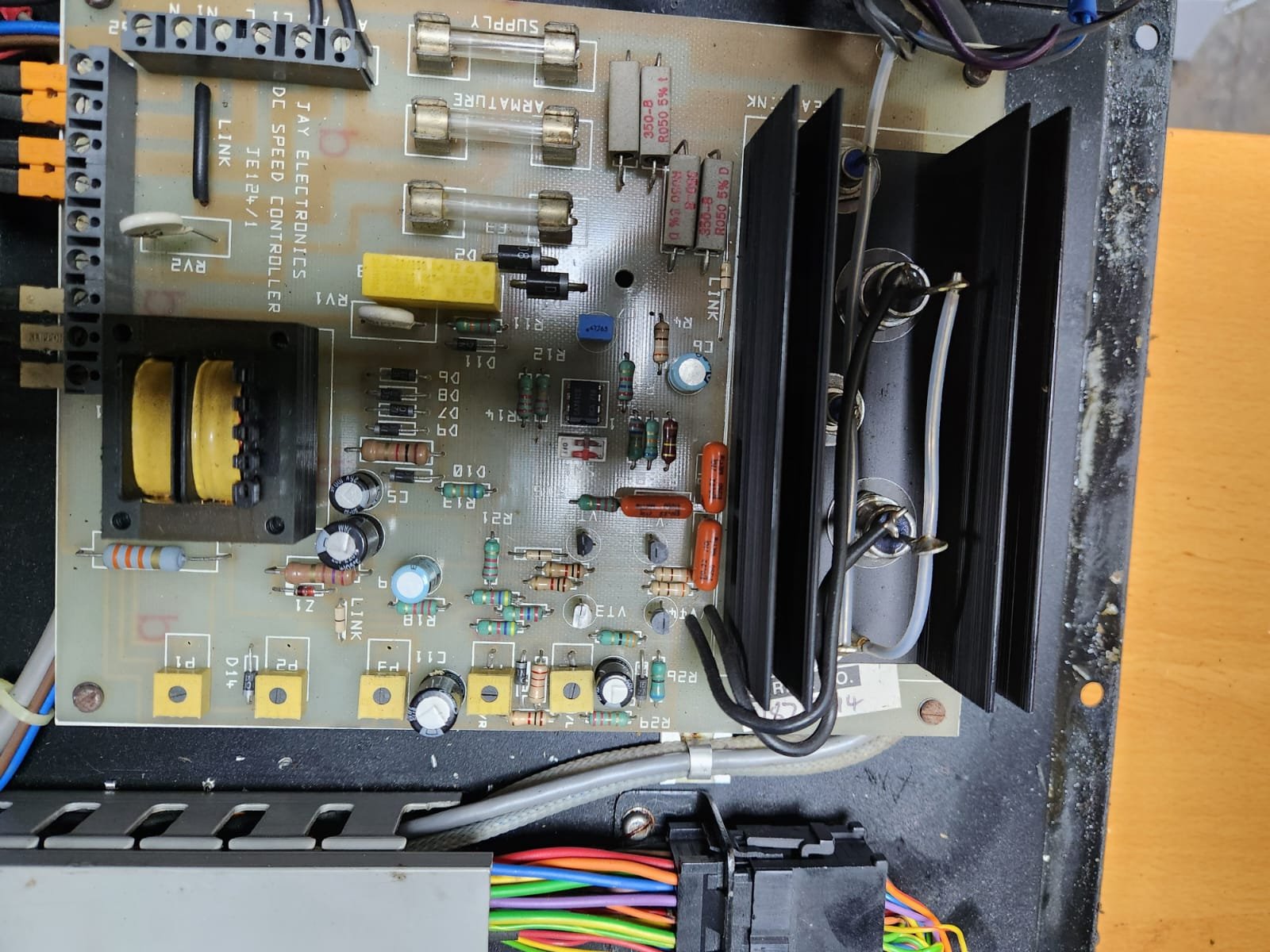

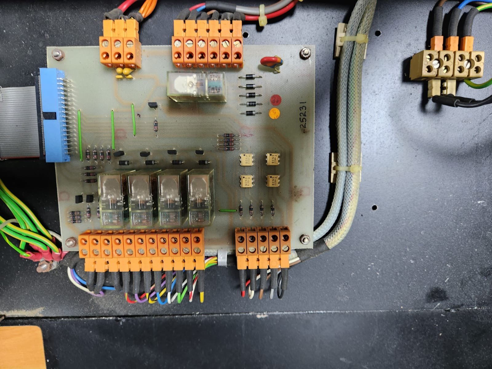

Let me figure out posting pics and i will. I snapped a few while I was in cleaning but i think the control board is hiding under the axis drivers
Re: New to me Starturn 8 what to do?
old Denford electronics
electronics tray.jpeg (373.17 KiB) Viewed 67861 times
Spindle driver.jpeg (302.56 KiB) Viewed 67861 times
relay board.jpeg (292.98 KiB) Viewed 67861 times

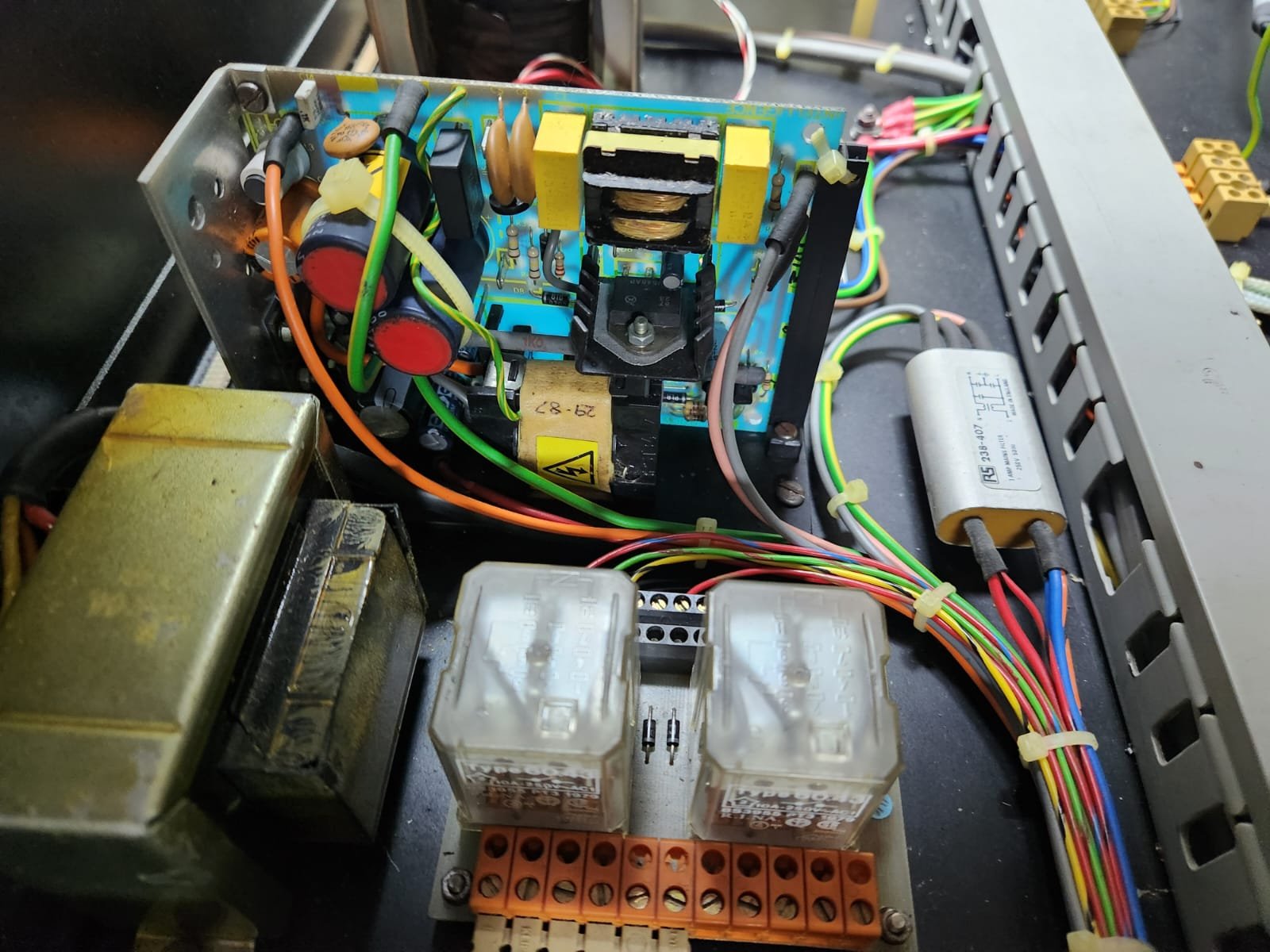

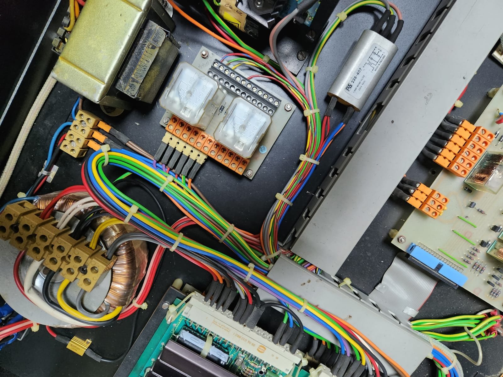

have to just give credit to Denford for a great layout and machine design.
dropping out the electronics was a simple and easy task. the machine was designed by an engineer that's for sure.
far more used to the norm where you open up a machine and still struggle to get to anything you need.

Just dropped in to see how things are going. Not well ATM but when I get chance I'll look see as it has been a while since i went through my old software box.
I'm sure Martin will know better but the later windows control, there are 2 boards, bottom board has all the stepper driver and connections for external relays, estop safety stuff, spindle control board (0-10v out I think), then the upper board is what I would call the logic board (afaik you can swap the upper boards to 'upgrade'), the older ones had a red 7 segment LED display, RS232 control and a Varta Nicad battery which tended to leak and damage the board (not required so removable). They then moved onto ones with green 7 segment, rs232 on earlier then usb later, The RED 7 seg boards needed an eprom with the correct information onboard, later were flashable, they had names like Denstep, Nextstep. I don't know the full gen on them but there is information about what boards can do what, compatibility with win7-win10 and various machines. The red 7 seg boards ran the VR V2 software although I think some earlier eproms ran DOS and if you got a later eprom or later board you could rune VR5 Now that is based on the milling machines. The only denford lathe I have worked with is my ST5 with the GSM dos control but I did do research into the VR conversion but it was 4+years ago and on hold!
