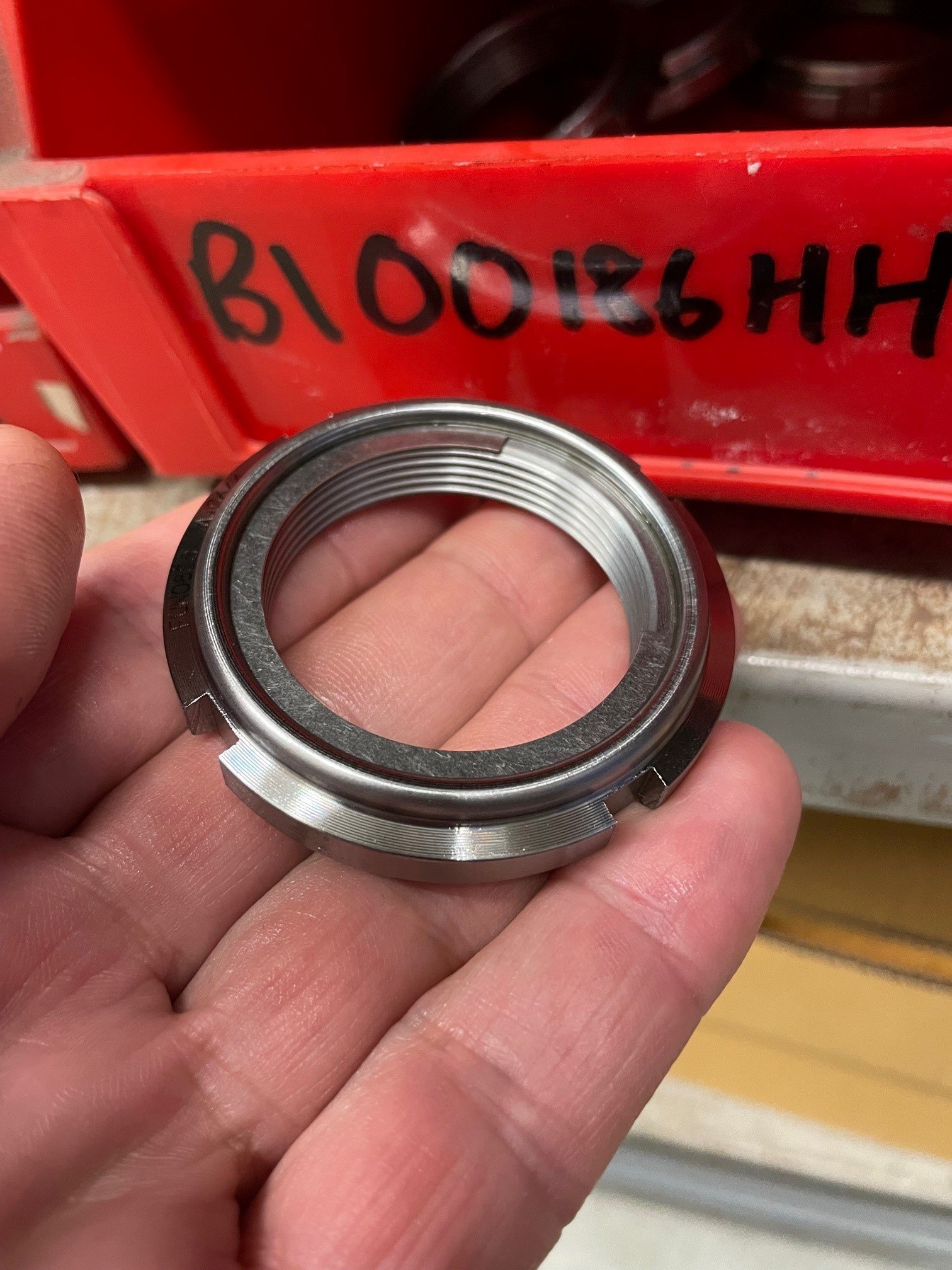

Is it the Locknut BI00186H that is coming loose?
We changed the style fitted when we designed the VMC1300. The new part is BI00186HH which has a spring steel locking plate on top. This could be fitted to your machine.
These are priced at £19

Just call Denford or email Sales@denford.co.uk
Locknut BI00186HH
The price has increased a bit but they are in stock
