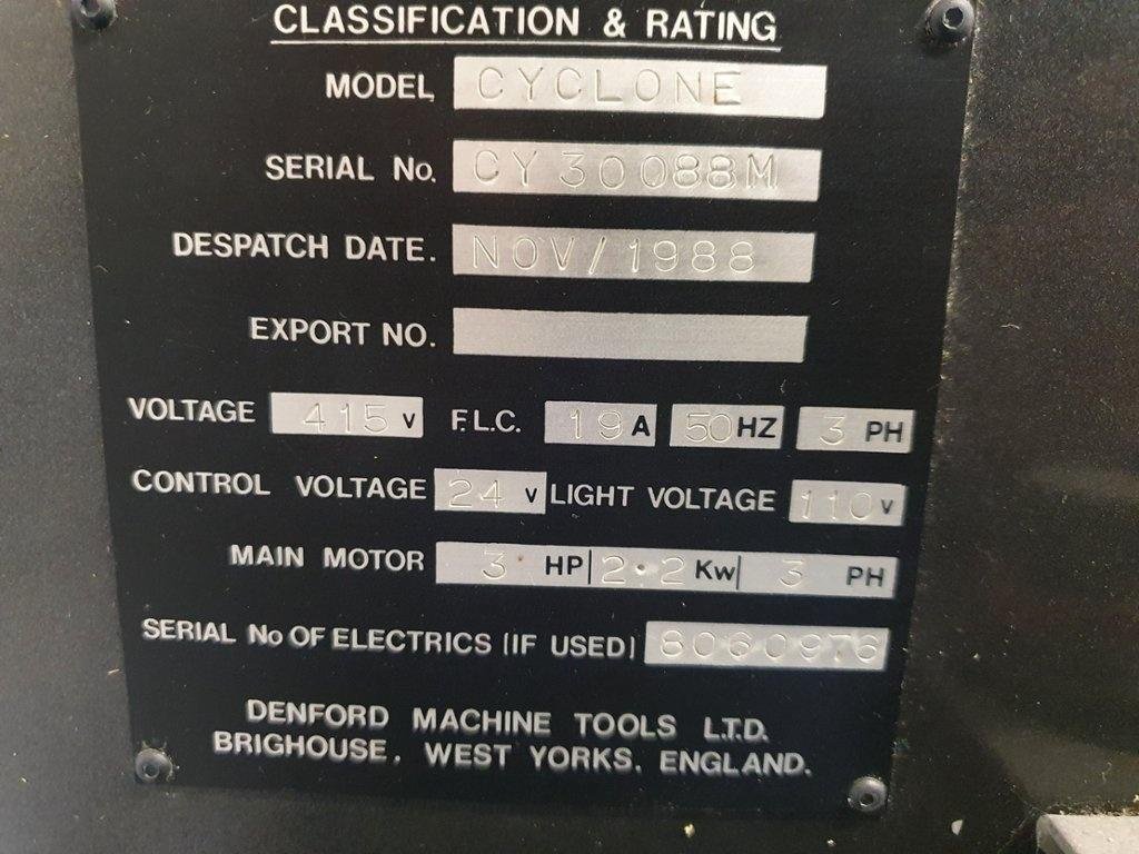

Hi all does anyone know if there is a Alphacam post for for a Cyclone lathe. I have just purchased this machine so all a bit new to me mostly ese cnc routers. Thanks
cyclone lathe plate.jpg (124.91 KiB) Viewed 18228 times
cyclone lathe.jpg (101.13 KiB) Viewed 18228 times
