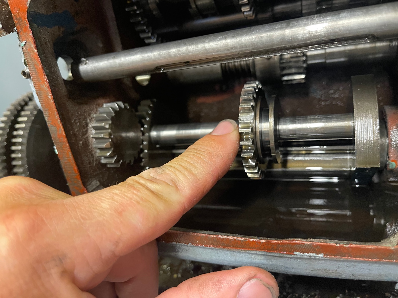

Hi I am after two gears from a 280vs gearbox. Does anyone know if there is a lathe being broken for spares anywhere? One is the 16t of the 2nd shaft from the bottom the other is the one that is moved by the rotary gear selector via the rack.

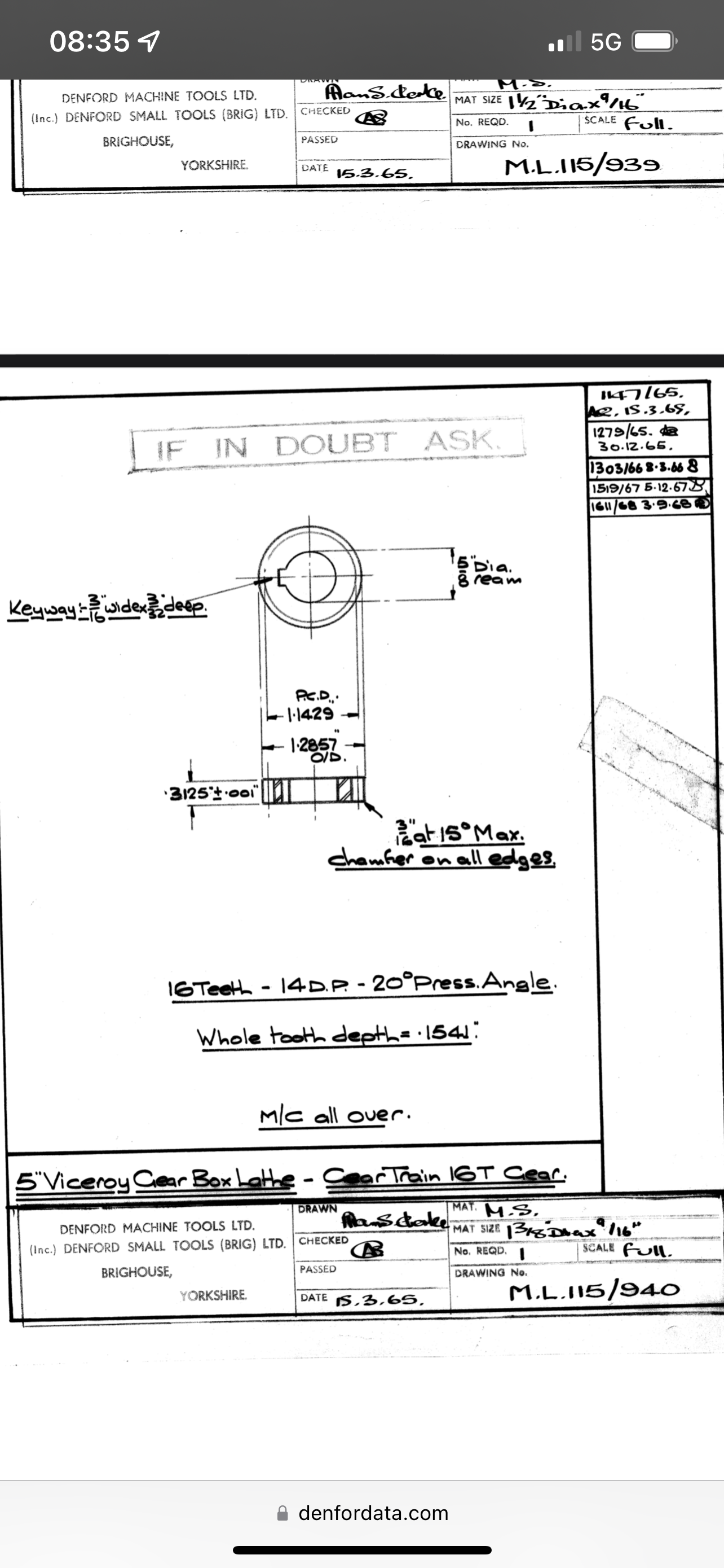

So below are the two drawings for the two gears I need. Anybody know someone who can make these please? Any ideas on cost?

I sorted it in the end bought two gears with enough material on them to machine the specifics from the drawing.
