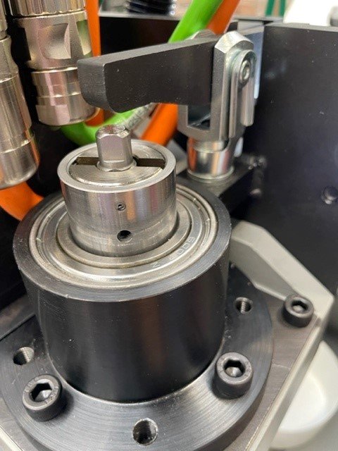

I attach the diagram for a VMC 1300 which is much the same. I will also include some photos.

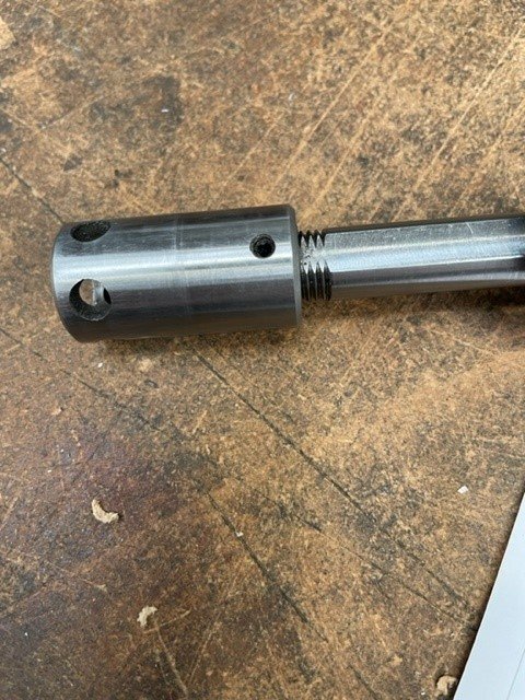

To remove the drawbar there are two nuts at the top that need to be removed VMC/0113 and VMC/0111 then the drawbar will fall clear of the spindle. Note there are four ¼” bearings that will fall out when the drawbar is removed. These should be stuck back in place with grease when refitting.
There are only a couple of things that could cause the tool to be loose:
VMC/0106 the collet that holds the 4 bearings should be fitted so that 4 threads are left visible on the drawbar and then this is locked in place by a grubscrew.
There are 44 springs in the spring stack and these should be fitted in opposite directions to each other. The first locknut (VMC/0111) is screwed down clamping the springs in place so it is 10.5mm below the top of the spindle then locked in place using a grub screw accessed through the hole drilled in the spindle. Then the second one (VMC/0113) is screwed in level with the top of the spindle and again clamped with a grub screw.

Steve, What's the best way to remove the drawbar rocker VMC/073 to get access to the drawbar locknuts? It looks like the rocker pivot has a sort of clip retainer - can I just ping this off?

Just a note to say I serviced my VMC 1300 Pro drawbar using the info supplied and it cured by lose tooling problems. I made a spanner from an old imperial socket to turn the nuts. When replacing the drawbar, not the orientation of the flat on the bar and the indent in the spindle so you can slide the bar up. My Pro has 5 balls in the drawbar.

I’ve rebuilt the drawbar mechanism and on the whole, things are better
3 out of 4 holders are clamping fine, but I have one holder that just doesn’t want to pull back and lock out on the spindle taper… despite being used without issue in the past!?!
I’ve swapped pullstuds, with one from the ‘good’ holders… still the same… so I’m a bit baffled by the situation! 😁
I have already moved back/up the front piece of the drawbar by one rotation, so 1.5mm.
My assumption was that this would induce additional clamping pressure on the pullstud/toolholder… but the problem is the same.

Can you remove the pullstud from the tool that does not fit correcly and check that it fits to the taper correctly. You should then see it it fits correctly.
The bottom of the drawbar should hit the top of the pullstud as you release the tool. This will help a tool release if stuck on the taper. Tightening the
This could cause more of a problemn as the top of the pullstud could be hitting the end of the drawbar preventing it pulling into the taper.
