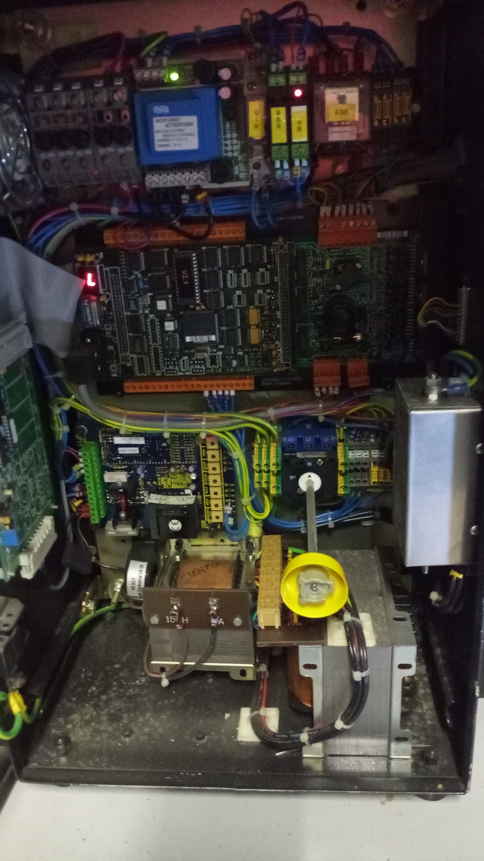

ImageHi Steve,
Thank you for your reply.
I'm not very familiar with the terminology.
I'm more of a user than a repairer.
I took a picture. The 7 segment display is on. Is that board the Denstep?

There is a component labeled SGR which has a LED and that isn't illuminated. Should it be?

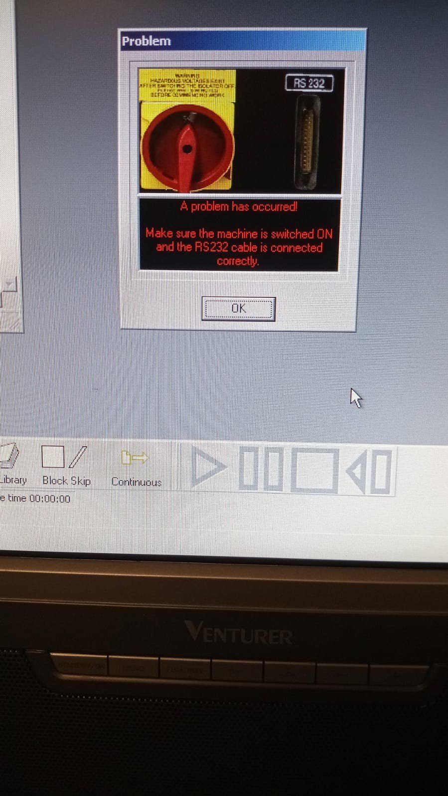

O also get this when the fault happens.
And then this when I click ok.

SGR is spindle go relay so lights when the spindle is running.

The 7 segment display does not go out when it fails. Could the little 2.4V battery cause problems. It had some sort of residue on it. Crystals of some sort. It may have leaked. Nothing went on the 9 pin plug below, I checked that and it clean as a whistle.

The battery isnt needed however it is possible a leak has caused some damage to the tracks of the board. Worth cleaning the board up (you could use some IPA) and inspecting for track damage

I assume that this little battery has a function, perhaps to keep the mint file alive? Anyway, I decided to change it. After I got it running again with the new battery installed I left it powered up for a couple of hours to charge it. Switched it off and on and all was still well, no loading of mint window. It came straight back up ready. Switched it off for the night and this morning it's still working, again without loading mint.

Hi the battery has no function on the board and could simply be removed with no ill effect.
The battery can leak acid and cause problems on the board so cleaning around the terminals may have helped.

Next to the 7 segment display or below it in the image higher up the thread showing an L on the display. It's a small NiMH cell.
