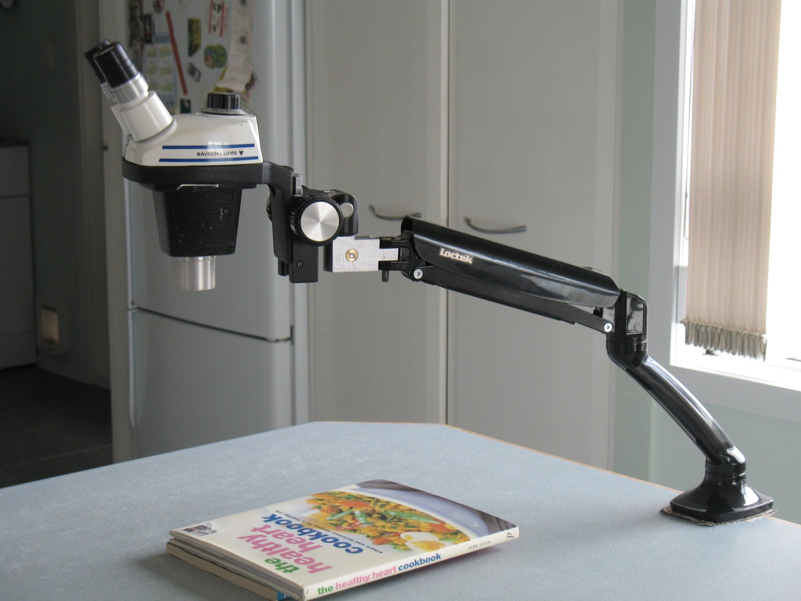

I purchased a Bausch & Lomb Stereo Zoom 4 microscope from ebay USA. This is for electronics, which use parts small enough to require a microscope to work with.
To reduce shipping cost, I found a microscope with a mount but no stand. The plan was to buy a computer monitor stand and make an adapter.

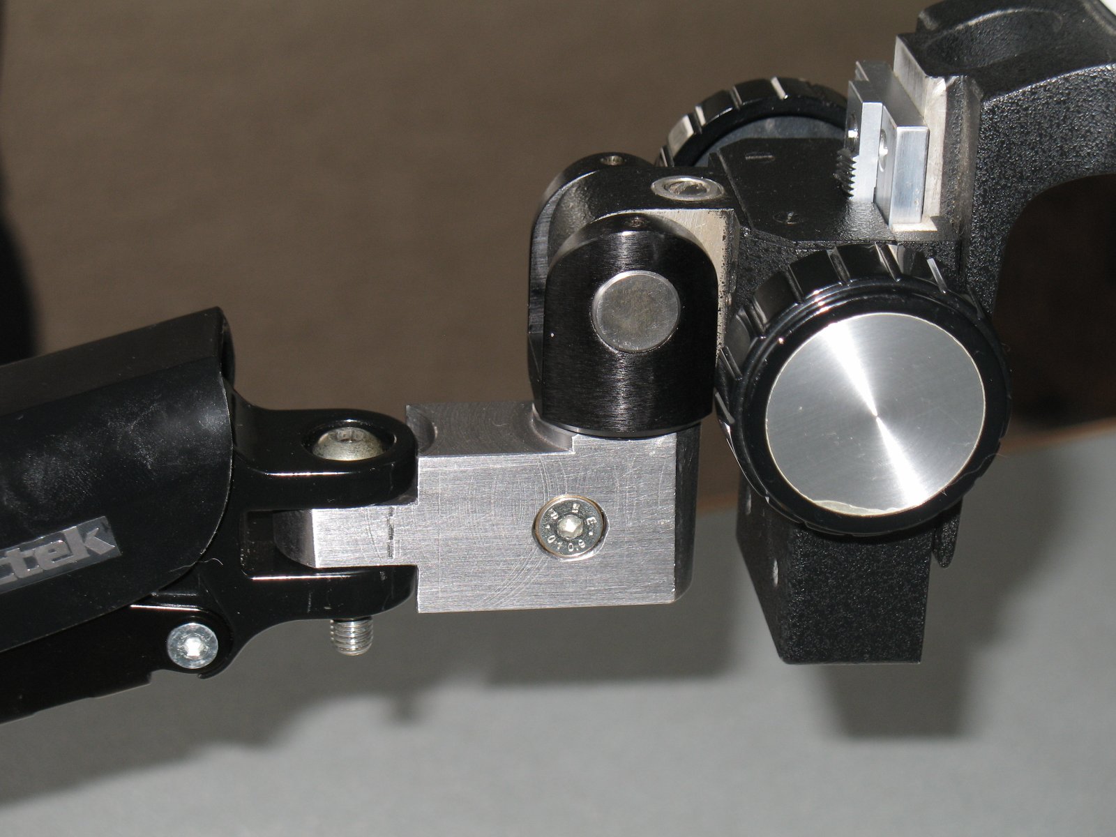

Although some surfaces were machined on a mill, most operations were completed on the lathe.
A close up of the adapter
The complete monitor stand, adapter and microscope

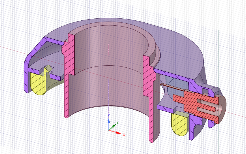

A CAD view of the adapter.

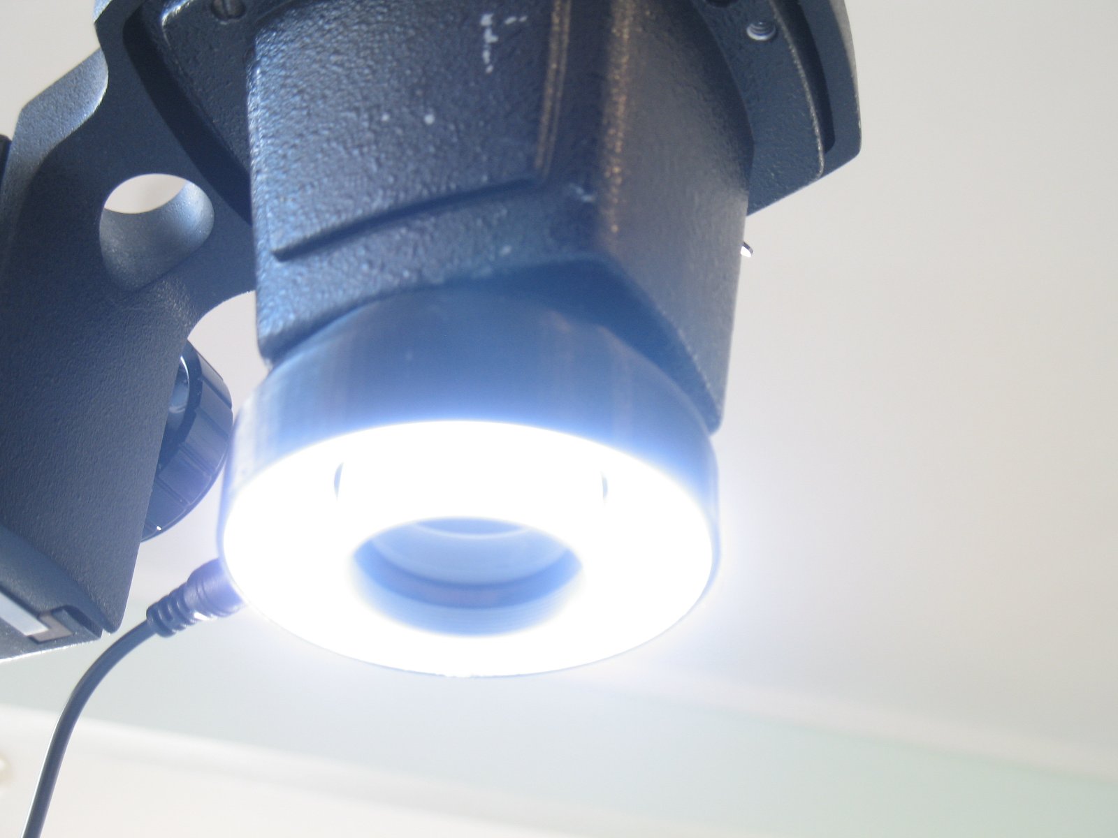

I also made a ring light 3D printed. Not done on a lathe but I thought would be of interest.
LED Ring Light X sect.png (497.64 KiB) Viewed 36340 times
SZ4 Adapter Cross Section a.jpg (139.18 KiB) Viewed 36340 times
